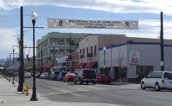

I hate em too - just don't do em like this
Vinyldog
Must have been donated
Okay about the photo - how do they get away with that?

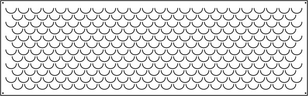

Here's the wind slit pattern I usually use. It's almost like using a mesh banner!
:clapping:

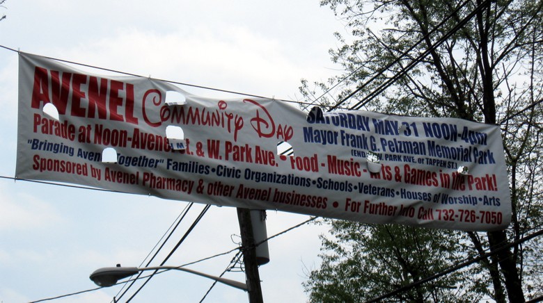

Found two depictions of what not to do!
Love....Jill
