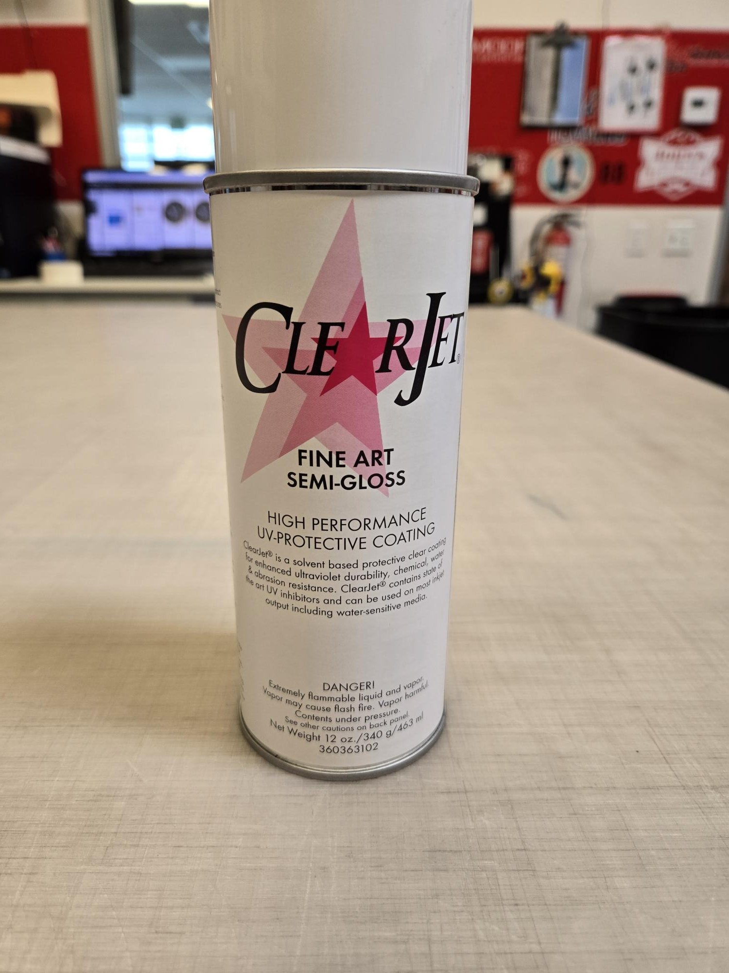

We use a satin spray laminate in a spray can. Spray it on let it dry, takes seconds to dry. It's in the section that sells liquid laminate - forgot the name?

Here it is. It's called "Clear Jet fine art semi-gloss High Performance UV Protective Coating.
