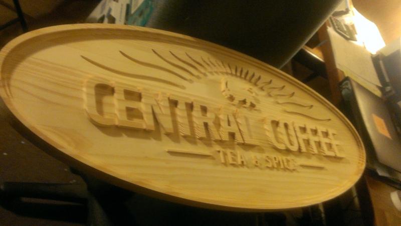

Hello everyone,
I've designed a wooden sign for a local cafe and we've already had a half-size (3ft) mock-up done in pine - fully CNC routered (by a friend who's keen to get better at this process) at varying levels to create a nice effect.
Now we have to source some beautiful (nice grain), durable wood for full-size version (perhaps as long as 7ft). We're planning to stain the sign (two tone) and will be having the letters painted. Our main issue is that this San Francisco cafe is south facing in full sun for most of the day - it's going to need some serious sealing / protection and upkeep I think.

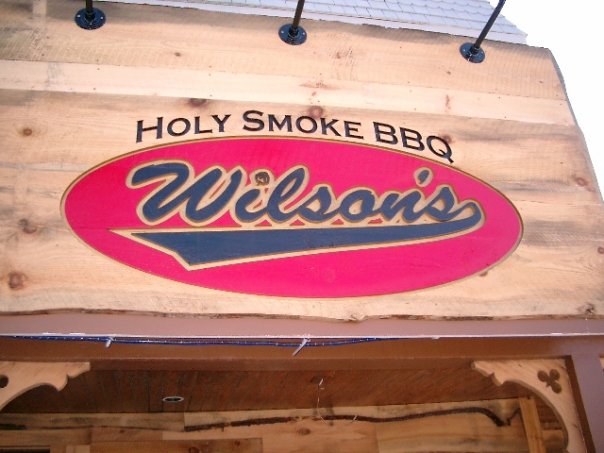

Here is a wooden CNC sign we made a few years back and painted with 1 shot enamel.We coated it with three coats of Poly clear and you should see it now.Most of the wood has turned grey after being beaten up in the direct sunlight.It does look good saying that as it has a distressed look.Not sure what the wood was the owner had it shipped in from Virginia and want to use it.We biscuit jointed it together.
Like Billct2 says Foam would be a good option.

The sign someone pictured looks like either oak or pine was used for that, based on the saw marks left behind, plus all the large knots. Oak is a hard wood, but doesn't weather like cedar, redwood or mahogany. It's known for it's ability to ash as with pine which is a soft wood and doesn't weather at all..... with or without paint, stain or any other additives.

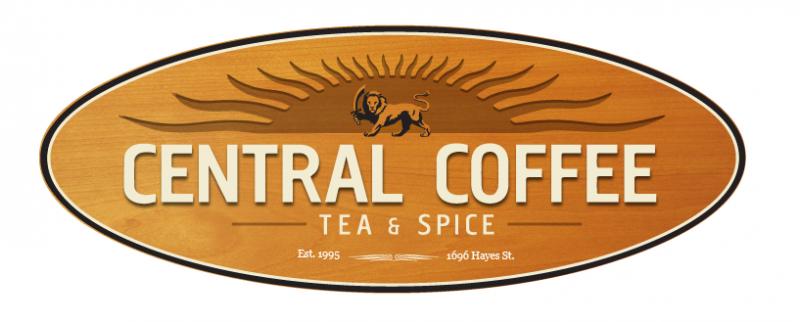

Thanks for the detailed information about my wooden sign production. I wanted to clear up a few things if you don't mind. I'm attaching an image I mocked up on the computer for the kind of effect we're going for- a 7ft long sign in exposed wood, stained, fully routered out and with the main letters left raised and painted.
We are currently unclear about wood choice and types of seal / protection - a major concern is this sign will be getting a LOT of sun since this San Francisco cafe is South facing.

I attached a color mock-up of the wooden stained sign we're doing - could you possibly take a look?
We'll choose a nice piece of Western Red Cedar I think and we just need to know exactly what product (Sikkens) we need to buy to protect it?
