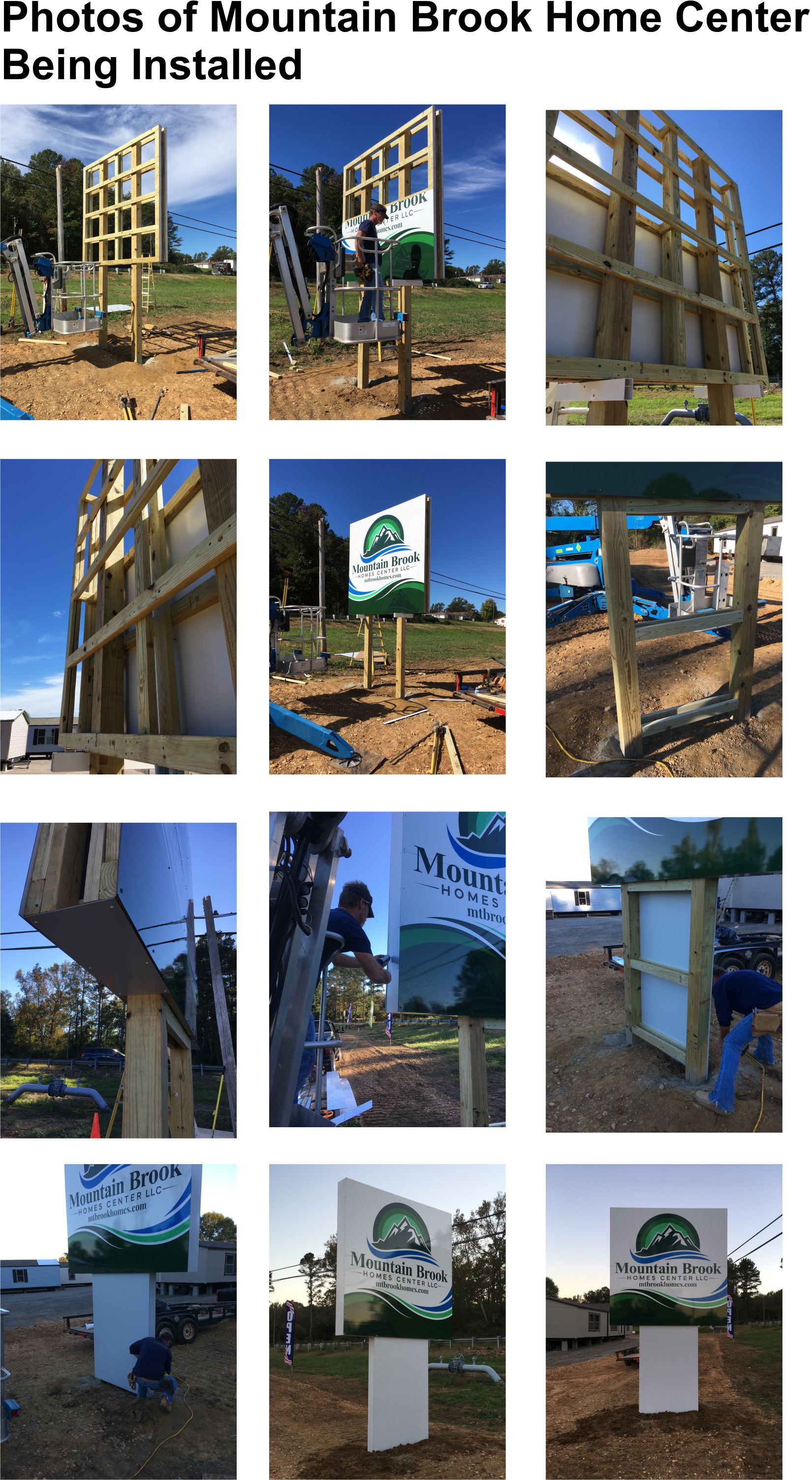

Thank you for all the comments. Thankful no one said I was wrong in my assumptions it was too weak. To answer StephenOrange, I did offer to make just the sign faces to fit their own construction, if they wanted to do that. To answer kcollinsdesign, the engineer that does calculations will charge me $350 minimum, but if I wanted it stamped with his seal, it is $750. I have used him before on jobs that required an engineer's stamp. So yes, in this case it may have only been $350 for my proof. To answer many that referred to the permit....The sign is part of a huge residential development that has been in the works for ten years, planting their own trees and doing most thing themselves. They are in a very small town (population) that covers a large geographic area and the town really welcomed them in for all of the property tax dollars that will follow. I have done several smaller signs along the way for them and they pay instantly and have been very good to work with in the past. They just now started actually building and selling houses and that is the billboard need. Because of the large development approval and maybe some politics, they can do whatever they want on their property and no permits are required for any signs they do along the way, as it falls under their overall project package. So, I have already said no to the frame part of the job twice and been clear about libilities and disagreeing with their "confidence," as they told me, so I if I lose them now, I do. Great comments and I appreciate them all. Thanks.

We have built small billboards out of 6x6 Treated Posts but not without a good 2x4 or 2x6 framing attached to the 6x6 posts.
The sign in your drawing looks like a strong wind would snap the 6x6's into at the ground being 15ft apart.
And I don't see how you could make the sign now "bow" in a 15ft span in wood without using steel.
I would quote that drawing in steel posts and steel framing.
I have built some small billboards that size or larger 20ft wide but always had at least 3 to 4 6x6 posts holding the sign up
with a good 2x4 frame to attach the sign faces.

McDonald Signs, Sweet work and great pics too. I'm impressed. I believe you could design and build a frame for this sign, same as me. The problem is the posts. Two post, 10"x 10", minimum. You can't buy them at Home Depot or Lowes.
approprite1, google around for Pilings. You need to move further up the lumber chain.

That's a really nice finished product! Looking at the completed pictures you would never guess it has a wood skeleton inside.
Do you use ACM or MDO for the faces/cladding?
