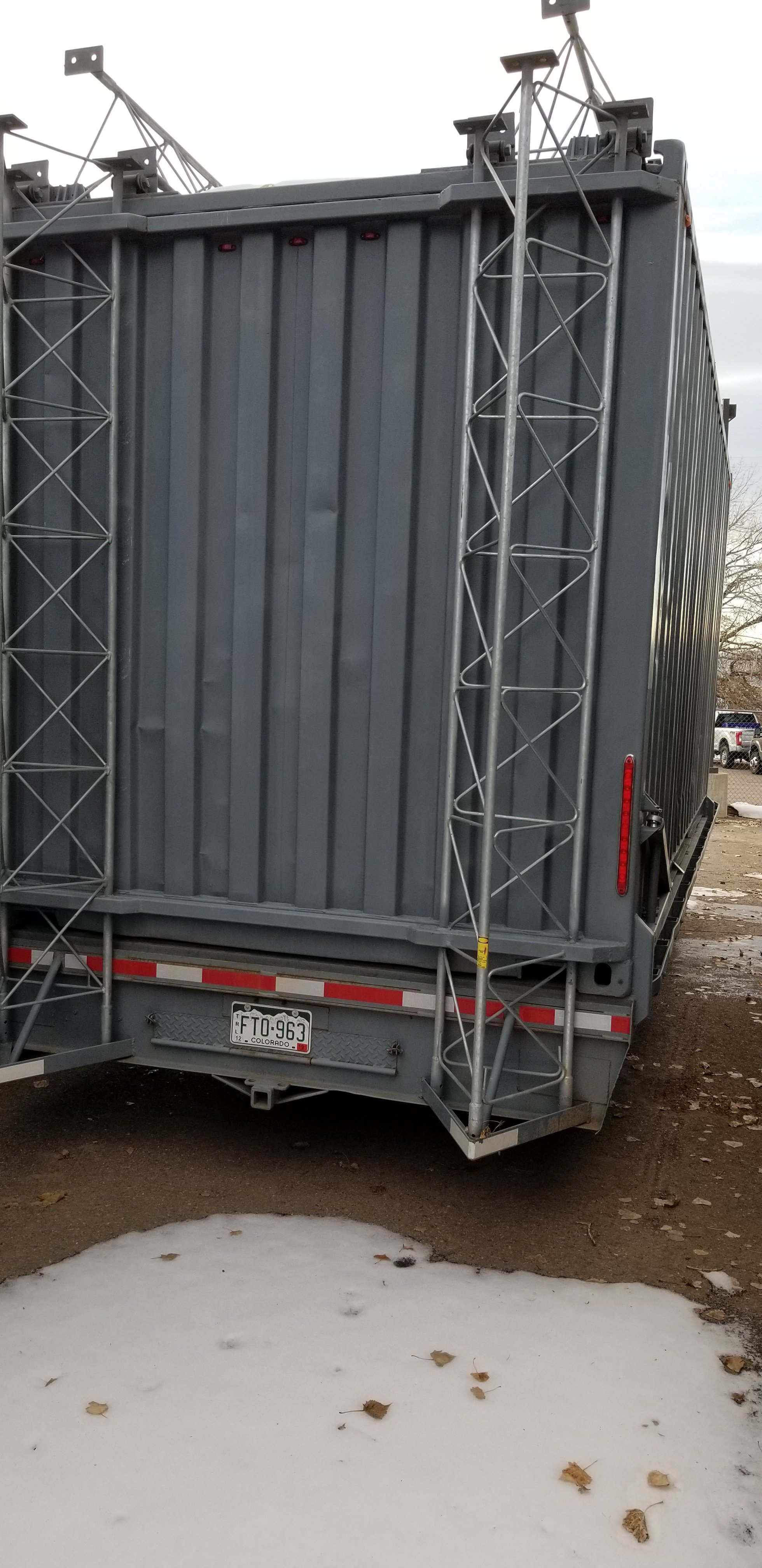

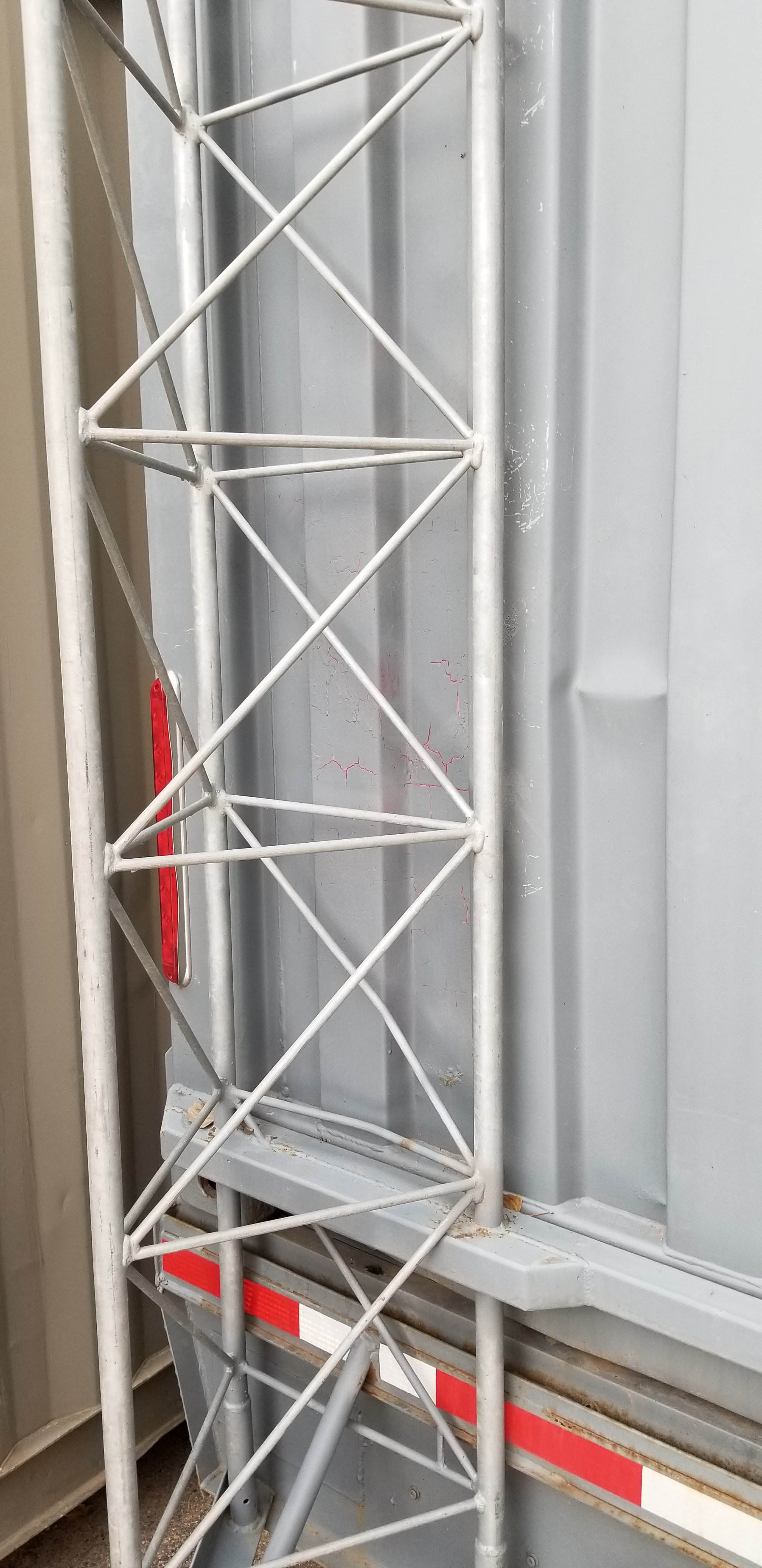

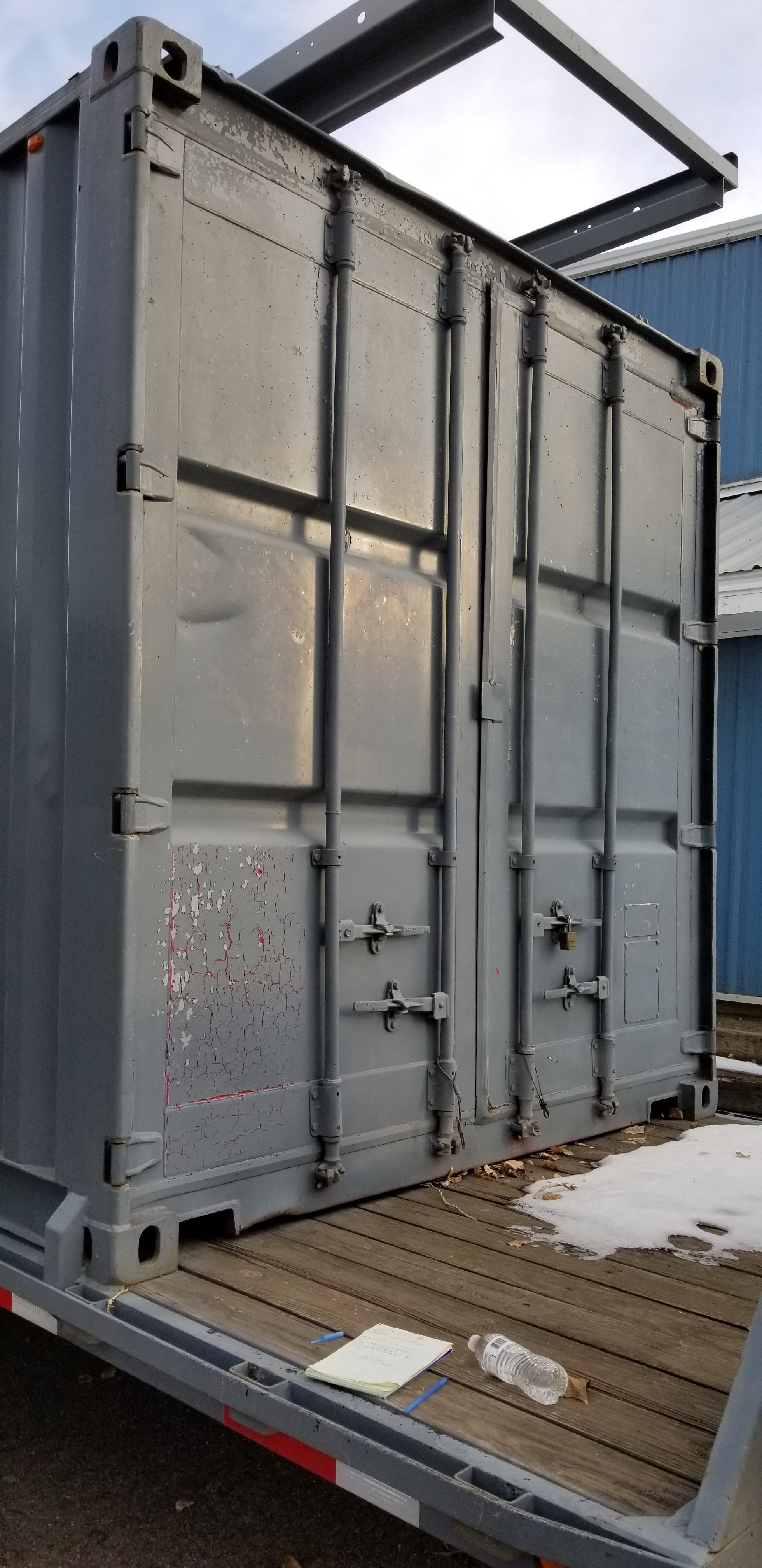

Would you accept this job? Is it even possible??
We have a customer looking to get a shipping container wrapped in vinyl. I am very hesitant to say yes. It looks like more trouble than its worth.

You're going to have to take very careful measurements to figure out exactly how much vinyl it's going to take to go into all those ribs. I personally wouldn't do it, but I don't wrap. No option for a simple flat panel screwed to the sides?

I hope they are not expecting you to wrap the doors as well? In that case, run! You cannot get the handles and bars off, at least not easily when it's a used container. Also, be prepared to maybe use a high tack vinyl, paints on these are tough to get something to stick to sometimes. I agree a wrap is not the easiest on these but on the sides it's doable with some time and patience. But be sure to put some "margin" for a PITA work in your quote! And also the sides require a bit more vinyl than the length of the container due to corrugations. Good luck!
Joel golden
Single color or printed? Are they expecting the ladder towers wrapped? Fleet quality or show car quality? I mean the sides are easy, the overlaps at the top and bottom of the sides will be a pain. The tubular ladders suck and there will be so many joints and pints of failure... then if they climb them...I’m saying nope even from a fleet perspective
