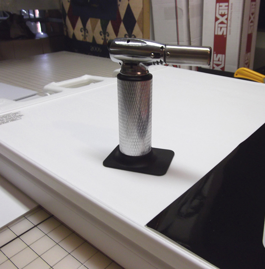

Today I had about an hour to turn out a A-Frame sign and take it to UPS for overnight shipping, all I had to do was mount the two prints… no problem.
Since the graphics are being mounted directly onto the Signacade A-Frame, it’s suppose to be hit with a flame before mounting the graphic. I don’t have a torch, just a heat gun. I want a torch, I REALLY do, but when burnt my arm pretty bad with a heat gun, my husband said “no torch for you.”
So today with little time to spare, my heat gun dies. This would have been the perfect time to go buy myself a dreamy little torch… but I’m so short on time and I know I have a spare heat gun somewhere. I’m wasting time looking for the spare heat gun when it occurs to me that I DO HAVE A TORCH!!!
Gosh, while I have it out anyway, may as well make some crème brûlée.

GypsyGraphics
that dessert torch was no fun, you can't even see the flame and the darn button must only be meant to be on in short spurts... hard to hold down for any length of time. guess their not meant to caramelized such a large dessert. and i hated wearing that tall white hat in the shop!
