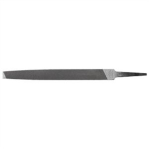

I have wrapped the edges of substrates but usually don't, and when I trim, I like to have the print bled .25" or whatever and use a metal file like shown to trim the excess away it gives a clean cut on the vinyl/print and rounds it just a hair so it doesn't want to peel up
