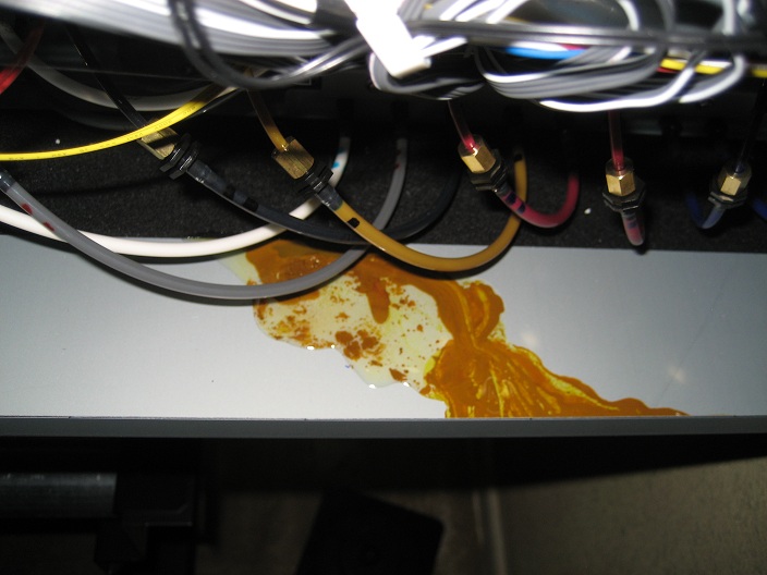

did up the days printing and laid it out to vent overnight. closed the shop down came in the next morn and was getting the next round of print lined up in versa when the Yellow's reservoir percent was off as in DRASTICALLY reduced from the others which was odd as this round of ink cartridges are just a few days old.
Pulled the cartridge to find the following....
After getting the hart palpation under control, called the tech (still under warranty) they thought I was joking. they came out and it was WTF!!! they had never seen nor heard of this occurring.
the problem now is the ink had gotten on the circuit board so no sure what with become of that and/or how long it was there so the extent of how much corrosion is unknown as of now
So proud that I'm special and can't have normal "issues" :doh:

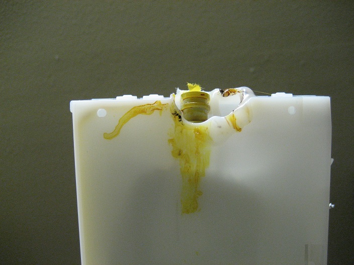

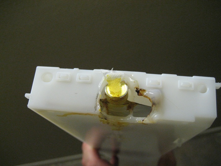

The model is a VS-640,
First thought was heat also, but none of the other cartridges show damage/warping/melting etc...
Closer inspection of the case shows the the plastic seemed to melt outward, implying the heat source came from within. But there is nothing producing heat in the ink cartridge case. The current theory is the bladder ruptured and the ink melted its way out :/

I would say the solvent ink leaked out of the nipple and on to the cartridge - I think only the bag within the cart is solv resistant not the cart itself
MikePro
+1
hopefully you've got no issues besides as a result of this. your ink supplier should at least be able to send you a new cartridge to replace the defective one. hopefully they'd cover damages it caused to your printer, if any, but its unlikely.
CS-SignSupply
Ink leaked from cart/neoprene and contacted the cartridge body...
Plenty of times run into Roland cartridges being damaged in shipping to find the plastic cartridge being completely melted still inside the sealed shipping bag... only the foil bag, chip and label was left...

Yes we placed the paper towel over the orifice to try and contain the ink leakage during cleanup. the pictures in the first post don't do justice to the amount of yellow ink that was splattered over the inside of the machine.
The concern we are having is after seeing how corrosive the ink was against the bladder case, what is it going to do to the wires/circuit board / etc...
that came in contact with the ink inside the case.
[FONT=&quot]It basically looked like a yellow bomb went off inside the case. [/FONT]
