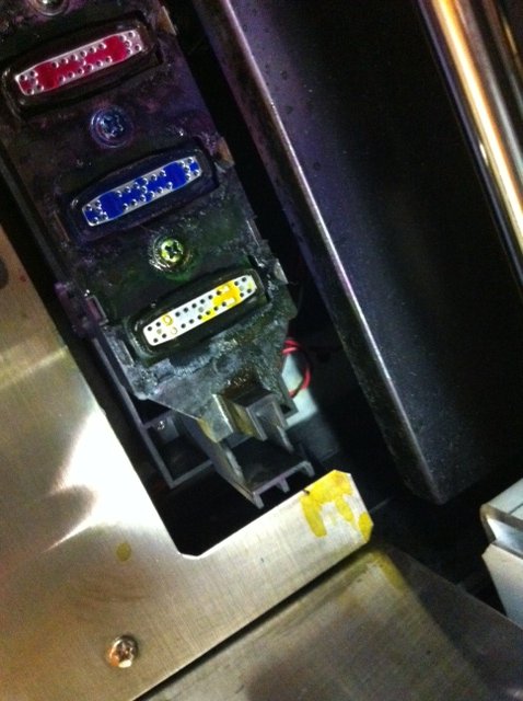

I am posting a pic of my capping station and you can see this build up of yellow ink about 2 inches away on the stainless steel. I have no idea how this is happening yet my prints seem ok. What I have found on some days is that the heads seems to be clogging up and I need to run nozzle washes sometimes 2 and 3 times a week simply to get the yellow head clean.
any ideas of why this is happening?

Looks like to me that your head isn't making a good seal with the capping station - probably why you need to run a regular nozzle wash. The head's drying out.

How does one correct this. I clean the capping station every night before leaving...what more can i do?
Masseria
Maybe need to Adjust level of Capping station, until its height is enough to seal the Printhead like the post before.
Done this on Jv33. Which printer you have?
artbot
i'd double check to make sure there's no yellow overspray. when the head goes over to the capping station, it spits a mist into the cap. constant build up over a day at this one position can show early overspray that really is undetectable on the print.
AnimalG82
I would check your dampers on the yellow, then adjust the capping station. If those don't help, I would replace the capping station. Its quick/easy and fairly cheap.

before switching the head, do a damper swap, a data swap, ...you can even do cap top swaps and pump tube swaps on some models. heads can be proven or dis-proven to be the cause of an issue. there's not "guess it's the head" in printer repair.

capping station was changed about a year ago i did have a head crash last week as well
dampers are full and not the issue
my printer is 6 years old so i dont think it is unreasonable to think i may need a new head.
not sure if this would do anything but the tech said my yellow screen was upside down

a data swap would show if the head is bad or not. if this tech does change the head, HANG ON TO IT!... there's an 80% chance that it is fine. i'd be suspicious of any tech that doesn't actually diagnose the printer. we'd never settle for that with a car. "well sir, let me start switching parts out and see if something good happens"... we've come to assume that a part can be isolated as the cause or not the cause. printers are the same.

UPDATE to the yellow issue.....
It seems to be the type of issue i can live with although don't think it is the head that is the issue.
I cleaned out the area of yellow mess and have not seen it come back over the last week and a half. I now am in the habit of running a test print every morning and during the day a couple of times and some days everything is fine and then yesterday for example I ran into problems.
I ran a test yesterday morning and the yellow head was 100% perfect. I ran a couple of small jobs and then realized on one that some of the colours looked streaky, so ran a test again and this time almost every yellow nozzle in the top 3rd was not firing.
i ran a nozzle wash for 50 minutes and ran a test again and this time it seemed just as many nozzles did not fire and maybe even more were not firing.
I then ran a 90 minute wash with a small piece of kim wipe between the head and the capping station.
Ran a test and a few more were firing but not good enough for print.
I shut the printer down and left for the day.
I came in this morning and fired it up and ran a test thinking I might be spending a good portion of the day getting this resolved and low and behold the yellow is back to 100%.
Can this be a head issue? damper? I have had the pump changed about 3 months ago and the capping station was changed about a year ago.
like I said in the past I am very maintenance driven with this machine so there is no abuse. I dont want to throw money away with hit and miss mechanics...

Sound to me to be a capping station issue. When you left with the kim wipe it causes the sealing ring on capping station to seal better!

I had issues with my Magenta doing that on my JV3 earlier this year. I ended up putting a couple of dampers in it and it fixed it for the most part. I think the other part was my inks were lying to me and I'd get air in the line. I ended up selling it and just saying it was time to get a new one after 6 years of service.
