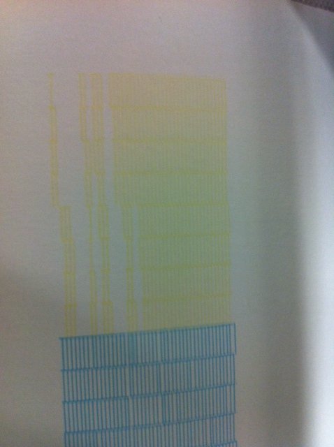

Here is how the print test looks..... now if you saw this on your machine, what is the best way besides a nozzle wash to get the head firing... As I mentioned last week, that when I found it like this I ran a few nozzle washes and it never got much better. I turned the printer off for the day and the next morning it was firing 100% perfect.... That is just strange....

Check your cap top hoses and the pump.
I have been battling the exact same problem for two days. My yellow head was acting up. (coincidentally) Tuns out the black cap top lost connection to the pump they both share and was causing a leak.
I ended up replacing both cap tops and yellow dampers. Cleaned out the pump as well. After a half day of bad prints after the repair, it seems to be fixed. I thought the head was going out. That head has nearly two billions shots on it, but it's still going fine after the tune up today.
The ink on the right of the cap top indicates (to me) the pump isn't clearing the cap top of pooling ink, and when the head seats to the cap it's squirting the ink out.
Think bowling ball into a five gallon bucket of water. SPLASH

Sound to me to be a capping station issue. When you left with the kim wipe it causes the sealing ring on capping station to seal better!
but even after that nozzle wash with the kim wipe it still was not firing. Turning off the printer and leaving it till the next morning did the trick....just exactly what trick it was is unknown to me lol

Can you explain how I do this check, I am no means a mechanic, but am willing to try and look
Jack Knight1979
I have a roland, so it will be a little different than your system.
There looks to be a stainless steel plate in front of the caps. Find the screws to take of that plate and there will be pump and tubes beneath that sheet metal. You'll have to move the head carriage onto the platen to do this, btw. Also make sure the printer is off and unplugged.
Trace the hose from the yellow cap to the pump and make sure that it's connected properly. Most likely you have another head connected to this pump as well. check that cap top too. On my roland I am able to spin the pumps with the same tool that drops the capping station down.
I'm not sure on a mimaki, but I imagine they are similar and you are able to spin the pump to verify it is indeed sucking ink. If the ink is pooling in the cap. The head is not cleaning and causing print failures.
Put a little flush in the cap tops and then manually spin the pump to verify the pump is moving material.
In my case. The black was moving the ink and yellow was standing still. After some tinkering I was back in business.
I hope this guides you down the right path to repairing your printer.
