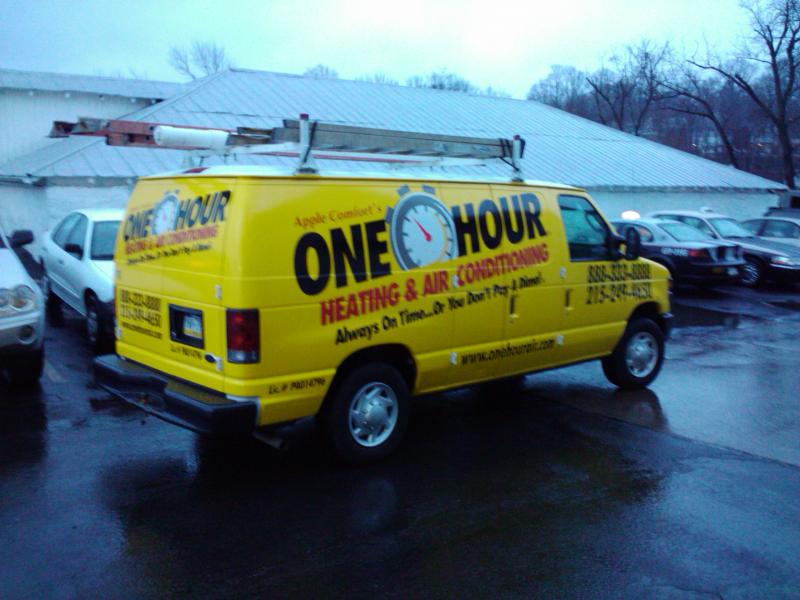

Thanks, and here's the scenario. This guy has a One Hour Heating & Air franchise, and has a van with a franchise supplied yellow wrap with cut vinyl applied on top. He wants another done, and wants a quote to match the first van. I think I will just quote it to apply another franchise supplied wrap and be done with it. I was thinking maybe I could make a little more on the job if I supplied the wrap material myself.

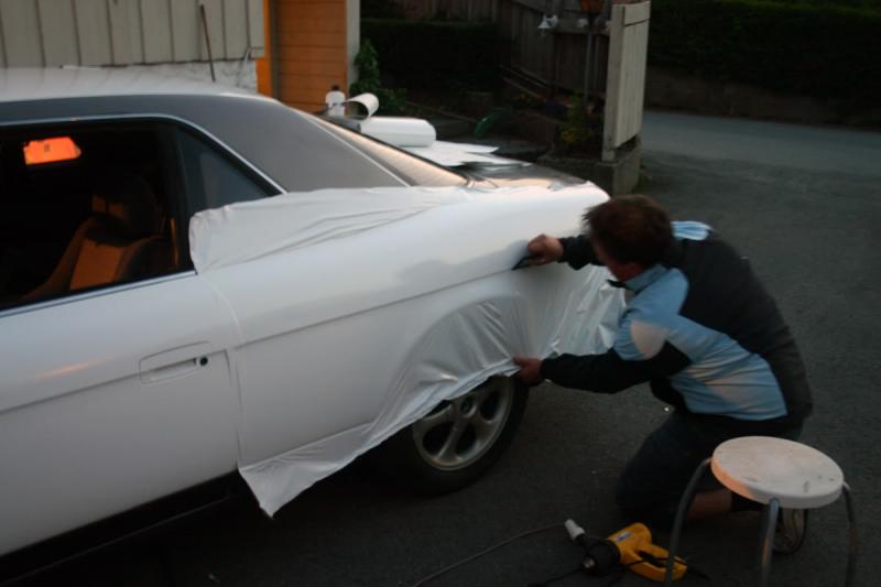

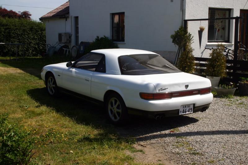

We used this vinyl to print wraps at a place I used to work before starting for myself, its a very nice vinyl to work with. Looking at the cars that are still around from before they got a laminator, I'd say definately laminate it if printed on.
However, I did my own car with the rest of a roll that had been in the shop for a couple of years, we wouldn't use it on customers cars, so I did my own instead of just throwing it away. Wrappet the car unlaminated, no problem, took it off two years later just before selling the car.

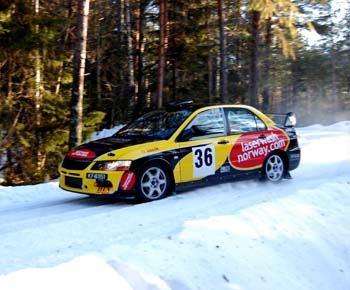

Come to think if it, we wrapped a couple of rally cars with this vinyl, and I remember the yellow one had a clear adhesive, while the white one had a grey backing/adhesive, so the original colour of the cars affected the results. This white Mitsubishi Lancer Evo went fine, but a dark blue Subaru WRX rally car, the yellow vinyl appeared darker because of the dark colour underneath. Where the yellow vinyl overlapped it became brighter because of the dual layers in the overlap.
So check this if the car has a dark paintjob. Is this the shade of yellow you are going to use? If I remember correctly, the 3M spec sheet on this vinyl states which colours that have a grey backing (blockout).

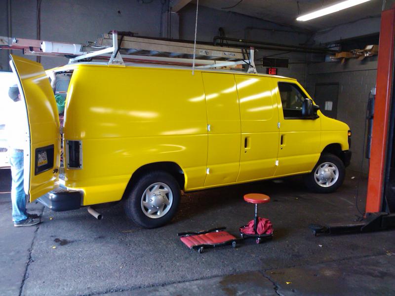

Me and my wrapping accomplice did this van today, 20 labor hours to complete. We used the 3M 180c series vinyl in bright yellow. This film was extremely translucent, so I spent several hours yesterday cleaning thoroughly. There was lettering to remove, which i had previously installed, so I was sure to remove all traces of old adhesive. Anyway, the 180 film was not TOO difficult to work with being so thin and un-laminated, however the adhesive was a bit tackier than the IJ180CV3 so care had to be taken pulling up the film when required.It tended to stick to itself rather aggressively. Extra care was also needed when torching and forming, but not too bad.Here are some pics.

Thanks guys! Hey- something else I meant to mention for the thread's informational purposes - remember to consider the paint color of the vehicle when making color choices with this film . Had this van been red, that yellow would likely appear orange. My accomplice and I were wondering why 3M did not use a grey adhesive rather than clear. I'm not sure, but all the colors in this 180C series probably have clear.
