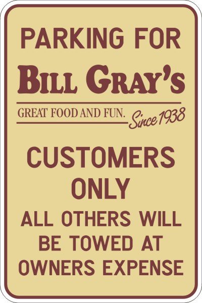

Which color would you lay first???
  • solid tan panel with weeded burgundy
    Votes: 28 35.9%
  • solid burgundy panel with reverse weeded tan
    Votes: 33 42.3%
  • screw it...I'm digitally printing
    Votes: 18 23.1%
  • Total voters
    78
Shovelhead
Just for fun.

I'd be in the printing category, but we would spray the background and lay the maroon on top, back in the day. If it was a lot of them.... flood them and screen them maroon over tan.
igneous
if the beige color was something else that wouldnt be darkened by the maroon - i'd do a solid maroon then the beige on top
markymarkmfb
If I had no other choice but using vinyl I would do the burgundy first- The reverse weeding of the tan would be much easier IMO.
Border
For the sake of having no visible bleed lines on the border, I'd lay down the burgundy first then the reverse-weeded tan on top.
But if faster weeding was big concern, I'd do the tan first then the Burgundy with the power weeding feature (used in Signlab anyways).
Print & Cut though, if you have the abiltiy, would be the fastest way to make a buck on that one.
petepaz
as long as i could hit the colors i would go digital
if not tan background first then cut vinyl burgandy
ddarlak
Go Bills!
since the tan doesn't extend off the substrate, i would lay the burgandy down first as to not have a trap...
weaselboogie
If you lay the burg last, you'd have some issues with the burg outline. Do you make it exactly the same size and hope that the edges line up, do you make it larger so the beige and burg lay next to each other butt to butt (shrinking vinyl would leave a gap) , or do you center the burg line on the edge of the beige (half touching the metal, half raised up on the beige).
Burg first seems obvious to me... so what if reverse weeding takes a bit longer, you won't have alignment and early failure issues.
Pat Whatley
Solid burgandy, reverse weed the tan. The little letters in GREAT FOOD AND FUN SINCE 1938 would be a pain to cut and weed. Plus, they're going to be pretty fragile should anyone decide to clean the sign in the future. Reverse weeding should make a better finished product.
and I'd throw an apostrophe in OWNER'S.
(on a side note, do a Google search for "at owner's expense apostrophe" and it will pull up mentions of the lack of the apostrophe in what appears to be every article written on punctuation in the last 10 years. Parking signs are apparently the ruin of the English language. Damn sign people.)
signpro
Manager
i'd load some tan vinyl into the Gerber Edge with a burgandy foil... wait, you said vinyl only...
i'd lay the tan first.
Joe Diaz
OT: Might I recommend saying "Vehicle Owners Expense" Long story as to why we do that now, but one could argue the sign says that the owner of the property is responsible for paying the tow company. And trust me, some have argued that.:banghead::rolleyes:
Baz
My toughts exactly! :thumb:
high impact
...only because the beige does not run to the edge of the sign I'd lay burg first and reverse weed the beige. Much easier line up. If the beige ran to the edge than beige would go down first.
