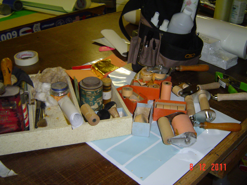

Roll leaf is usually 1", 2" or 3" wide rolls. It's true gold leaf, nothing that can be printed on with any machine. This is primarily the technique I personally use for any gilding jobs. Our gold is 23-1/2k. I have 1", 2" a custom made 2-1?2" and a 3 " roll handle. We do not laminate, but clear with liquid on certain jobs when finished with the appropriate clear after everything is finished.
Sign Gold I believe is 22k and not truly considered a gold leaf product by most die-hard gilders. However, it can be printed on and laminated.
Here are some gilding tools and materials and some digitally printed Sign Gold products

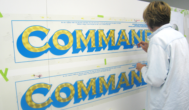

Hand laid 23k leaf looks 100% different than 22k vapor flashed sign gold. Not even comparable. Also, when purchasing a stock printable roll of leaf from LEO for example, #1, you waste a lot of leaf and expense on gold that falls outside the letter area and #2, the swirl is one size and ends up being randomly scattered across the letters.
Without divulging too much of our process without the boss's consent :) basically you make yourself a registration point to register all subsequent prints off of. Print your layout but don't cut it. Take the vinyl off the printer and size/gild/tint/coat like you would on the truck but on the vinyl. Register it on the printer, print the layout again to trap and outline the edge where the size was brushed on and gilded, and finish it like an other print. Now, that being said there are some ins and outs and steps to take to avoid certain problems... but you get the jist of it I hope. The striping is a different case. we've had special machines built that stripe the size down, then we gild and a tool mechanically swirls the strip to ensure it's consistent throughout, we then stripe the edges with paint and then we have a custom made cutter that cuts the batch apart into individual stripes. 23k with black borders (or custom colored) sent out in 18' rolls ready to apply.

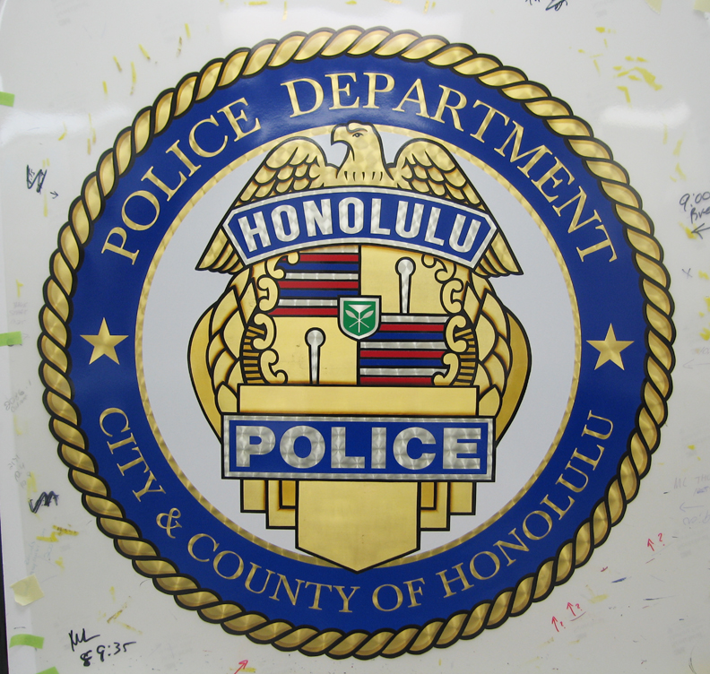

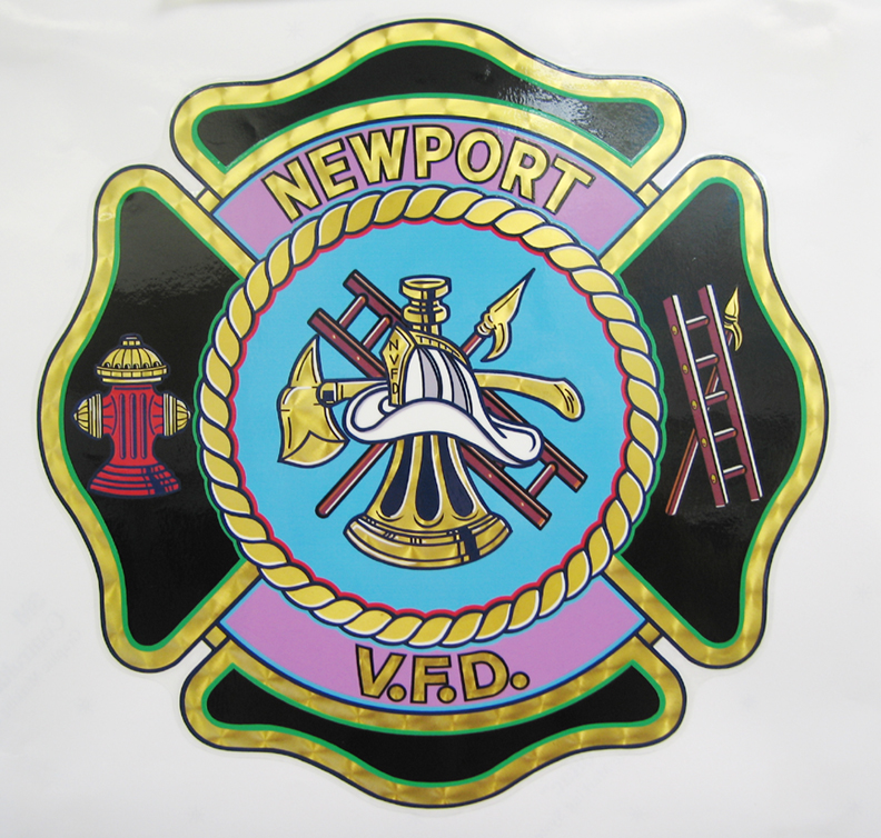

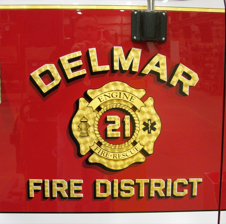

I may be a little bias regarding this for more reasons that the fact that genuine laid leaf is the lifeblood of the company i work at. I have numerous family members who are firefighters, and there is a lot to be said about the pride and comradery encompassing the trade. It's not just a job to most firefighters, it's a way of life, and one whos history is highly regarded. Genuine gold leaf graphics are part of that history. We are trying to keep a tradition alive and far too often are people opting for inferior simulated options. They don't look as good, they don't last as long, they dont instill the same amount of pride or nostalgic value. I implore you all to not just talk customers into taking simulated stuff just cause you can do it yourself, or it's cheaper. Even we have a dealer network and sell for resale so it's not like you can't deliver genuine gold even if you don't have the resources personally. The fire dept and firefighters will appreciate it.
There's no replacement for hand burnishing, hand painting, etc. No random pattern pre-made material is gonna look as nice. Some of the metalized engine turned material commonly used these days is only rated for 3 years outdoor, IF it even sticks to the truck after the first wash. This is a worthy investment on the departments part? No. I've seen some 'smart' gold applications fail miserably as they de-laminate, and shrink. not to mention less than optimal gold leaf full of flaws. Take care of your customers, especially fire fighters. They put your house out when it's on fire.
