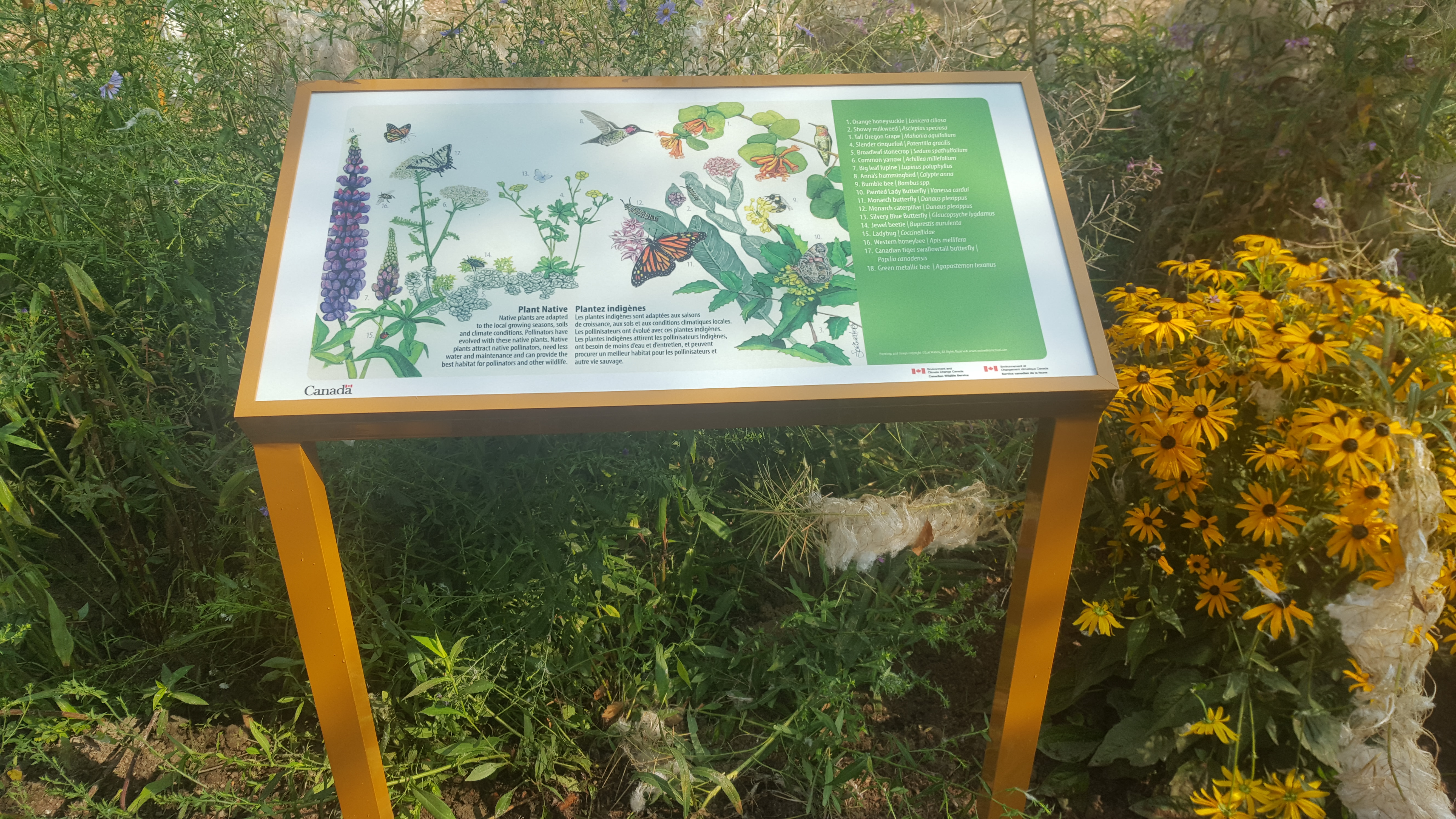

We do a lot of rain garden signs. So areas where the ground is made of soil, and gets drenched every day. Usually they're at schools... So there will be kids hanging off them, jumping off them, etc. Never have we had one tip or shift.
