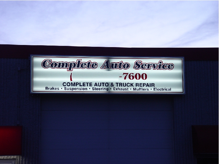

Here is the example I show people.

Bulb spacing plays a part in this also. The closer together the bulbs are the brighter the whole sign is making the banding show less. I don't think there is a hard and fast rule. There are lots of variables.
