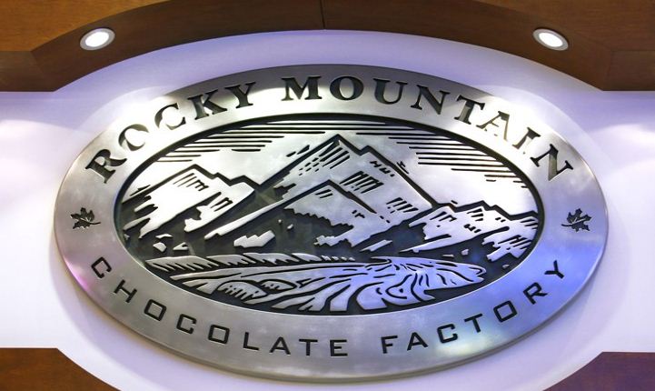

attached is a rendering and a photo of luminore. haven't used it before but i keep seeing more and more of the stuff around houston in projects. seems like it's time to figure it out.

when i say "luminore" i mean polymetal. smooth-on has a version of the same. i have a bunch of bookmarked companies on anther computer that do luminore-esque products.
the whole system is extremely forgiving. hell, you can make "poly-bronze" by putting bronze powder from the art supply store in just about anything and it will come out looking like perfect polished bronze.
the sales pitch is to convince the customer that there is this secret polymer that makes it work. there really is no secret polymer (at least for interior). almost anything will work. there is one company that actually sells about twice as many ores as luminore. that is the one that i will be getting my ore from.
the real secret is in the polishing. i've got the entire line of nuvite compounds, a cyclo polisher, tons of 3m buffing pads and 3m trizac. the secret, to me, is in the machining of the material down to a polish. that takes experience. ...knowing what it will take, what to look for, etc.
