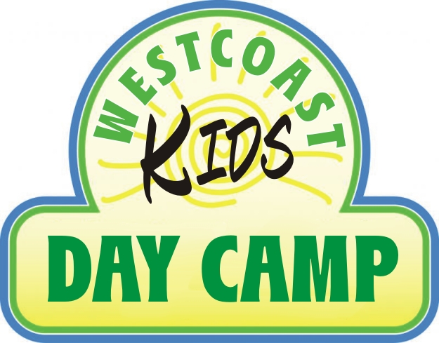

I've come up with a few concepts for this logo. None of them are complete. I just want to see what you guys like better (or hate more) to see what direction I should be going in. Your advice, input and constructive criticism are appreciated.
  • Arch.pdf
  • Sun.pdf
J Hill Designs
very kidsy and fun...
It might be better to attach jpg so noone has to open an external program to critique your artwork...

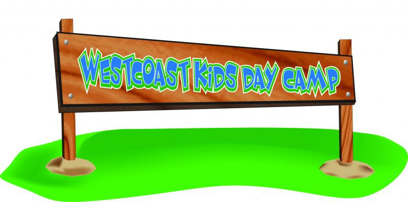

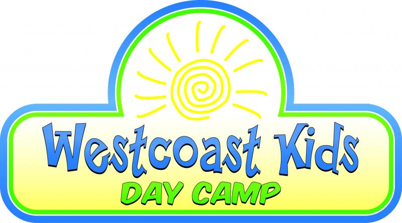

Ooops, I screwed that up. The system would let me load the 3rd file. Here it is. Hopefully this works. I'm also big on white space.
Joe Diaz
OK now I can see them. On the first one, I would try not to have an italicized word on an arch. And on the second one, which I like better btw, I would make the green a darker blue and the blue outline a brighter green. It will make it much easier to read.
Jillbeans
They are all really hard to read.
#1- I have been taught never to use red with blue on a sign. And italics on an arch isn't a great idea.
#2-Has most potential but use the decorative font for only one phrase. Something needs to be easy to read, DAY CAMP would be the best one for something paliner in blue only, no outlines.
#3-Extremely hard to read, maybe step off the outlines. Weird spacing, wood grain effects are disproportionate.
...you asked. Not trying to be mean.
Love....Jill

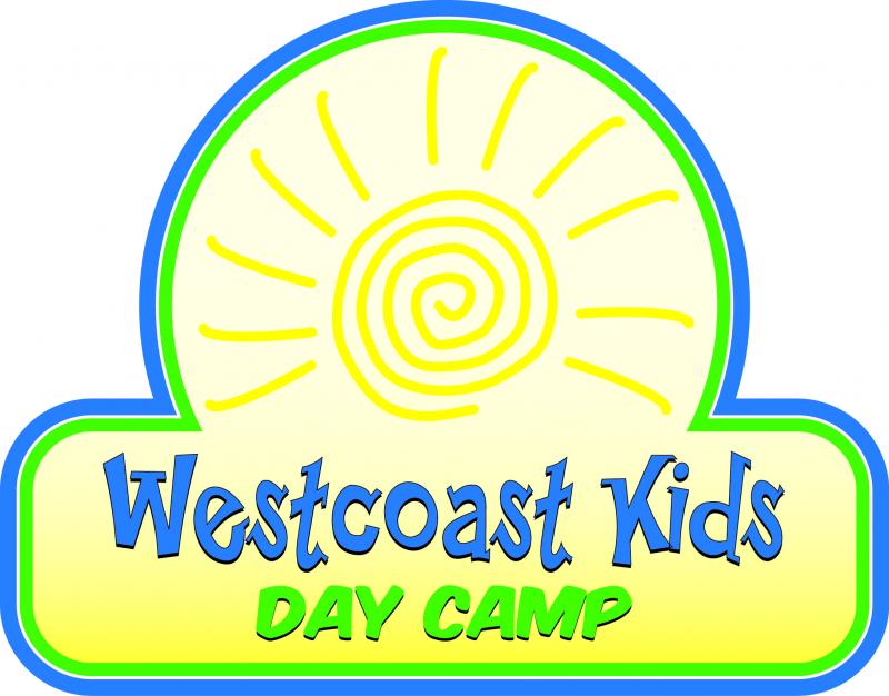

Sticky Signs
Ok, I borrowed some ideas from Jill. Thanks Jill.
Might still need some work. let me know what you think

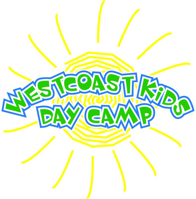

sardocs
It seems to me that's a lot of space used up by the yellow swirly thing. This might be an alternative...

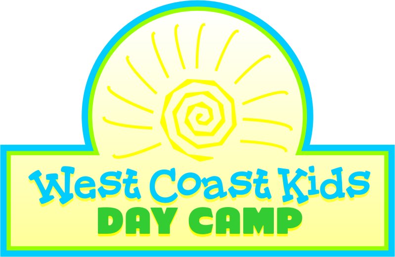

Sticky Signs
Thanks for the ideas guys. Much appreciated. So I sent my friend the same images I put on this post. She liked the one based on Jill's idea so I did some more tweaking and this is what I've got so far. Thanks again Jill, I owe you a beer!
SignManiac
I think it has improved greatly but, the two different typeface shown don't look right together. I think Day Camp needs something different that will look right with the Kids font.
