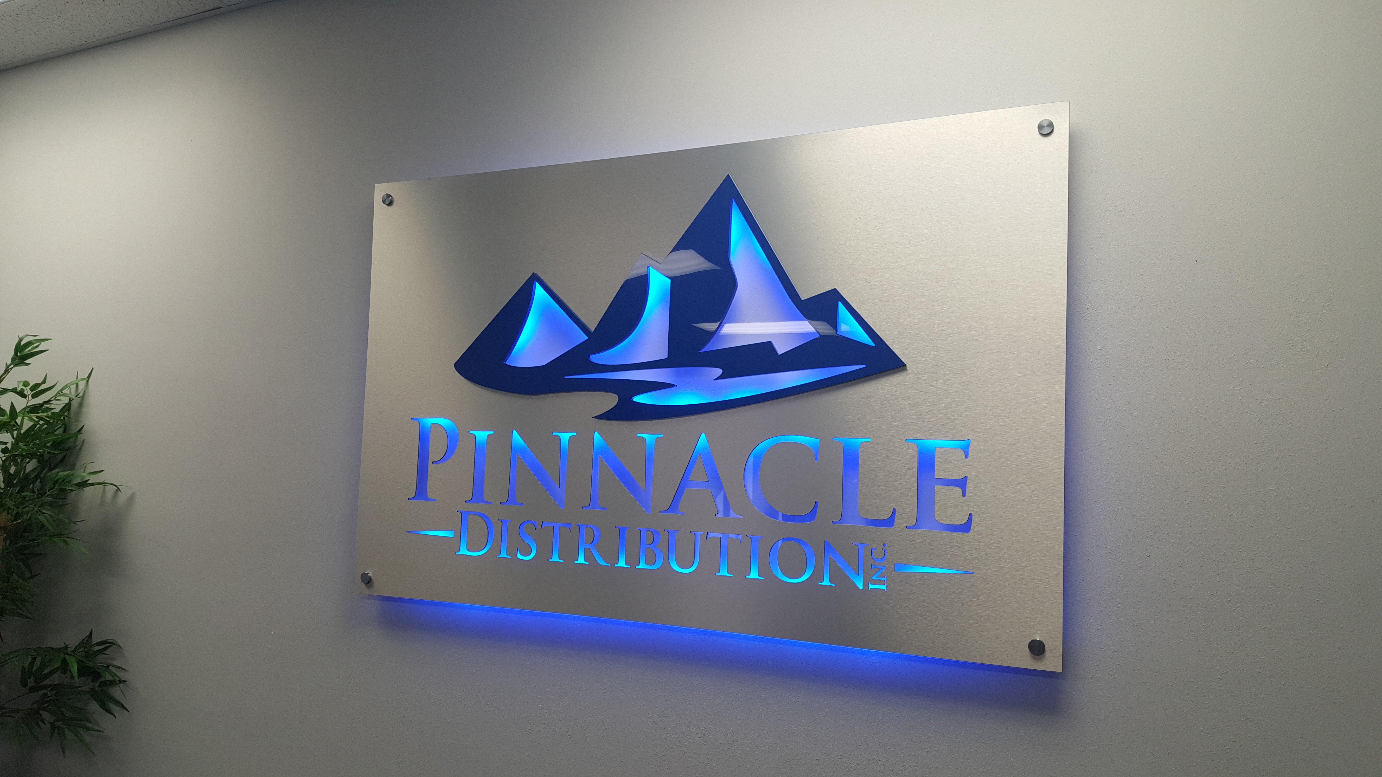

Milled Out ACM Panel, backed with clear acrylic.
1st surface 1/4" blue acrylic accents around mountains.
Blue LEDs illuminating wall with 1" grey steel standoffs providing spacing.
(customer had junction box installed behind sign in advance of install)

Do you have any pictures of the backside, before it went out the door ??

I really like how you used the 1st surface acrylic.
Which kind of LED did you use?
JTBoh
I sell signage and signage accessories.
LEDs had one horizontal run across bottom, under letters, one horizontal run across middle, above letters, and a zig-zagging one that followed contours of the mountains at the top. We put wire in between the runs to space each run. Was standard, blue LED modules, cant recall brand, would have to ask. I dont think we snapped a pic, unfortunately.
