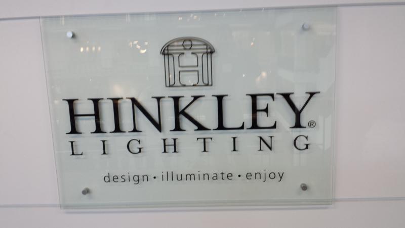

I have made my fair share of acrylic office displays. They are my favorite types of signs simply because the finished result can be so rewarding but they are also the most painstaking in many instances. Take for instance this acrylic sign I did.
It's nothing complicated. Black vinyl cut in reverse and applied to the back of a piece of 1" polished acrylic. The problem is every single blemish and impurity that may find its way underneath the vinyl will light up like a Christmas tree. Any experienced sign maker knows it can be a challenge to make sure vinyl is applied with absolutely nothing underneath but with these types of signs, it often warrants a redo which poses another issue. Removing the vinyl can lead to tiny nicks and scratches in the acrylic. Then you may find yourself buffing the scratch out which adds a significant amount of unnecessary labor. One tiny hair can lead to a complete nightmare. I am not able to create a clean-room environment so this happens more than I would like. Here are several other acrylic displays I have done. Most were issue free but others were not. Again, the results are definitely brag worthy but a pain to push out the door. Anyone have similar issues? I would love suggestions on how to solve.

hinge & wet apply.
moisture kills the static. can even overuse your application fluid to flush the surface of your acrylic prior to setting the vinyl-down.
...and keep a clean area. I get smacked when I buff sign panels, especially recently-routed acrylic/aluminum with scotchbrite/sandpaper anywhere near our application table.

The biggest problem is the static charge inherent with Plexiglas. I clean the table with alcohol leaving is slightly damp. When I clean the surface of the of the plex I mist the table around it as well. Also make sure the back of the liner on the graphic is clean so you don't transfer anything to the plex.

also a clean room and don't expose anything untill your ready to apply.That is leave the mask on the plastic till your ready to apply

We also finish using an anti-static ion air gun (ours is a meech). We spray down everything, including ourselves, to help eliminate any contaminants and static.

The big guys (Fastsigns, Signarama) have a 10% redo rate and that is how I have modeled my business. In fact, one of the big sign franchises near me had a 25%+ redo rate... 3.5% would be nice but we do a wide variety of signs so that would be a hard number to achieve. I used to work for this company and ended up buying it so I was the professional who did signs like this for them and have always had issues with this. I do have a "clean"ish environment but I only have 3000 square feet to print, cut, apply, and fabricate so it is hard to keep things clean and static free all the time.

Reason I ask...we do lots of acrylic plaques for a good customer of ours. I can't really go into details about all the materials used...but we do reverse print on clear then mount to acrylic with a laminator. Our laminator can't handle 1" acrylic, but there may be some out there that have a larger nip.
Regardless.... doing full panels rather than cut does increase the area that can attract dust etc...but the advantage is that if you do end up having to strip it, you're stripping one panel rather than a bunch of cut letters which as you mentioned can lead to scratching the acrylic.
And Tammie's suggestion about glass is a good one....we work with tempered glass just as much as we do acrylic and it is much more forgiving.
A couple things to think about.
I reverse print on clear, laminate onto acrylic, and overlay with white as white completes the color mixture. I can't print white but my laminator can handle 1 inch if I depress while the material is partially loaded. I have never worked with glass but it is something to think about for sure!
