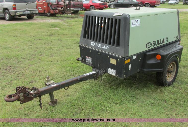

for sandblasting anything........this is your best choice. can rent em. i am lucky thwe wife works for a big construction/maintenance company.....and i can barrow one when i need to.......
