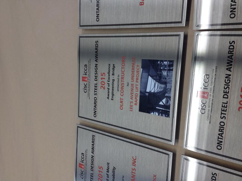

Have you tried telling Gemini you need them sooner? I have always found them to be very accommodating to me. they just turned around a project for me of 45 flatbed printed stainless steel plaques in 1.5 weeks, made me look like a rockstar to my client!
