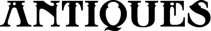

i saw this font used once on a dimensional antiques sign and loved it....

iam with most here, FONTS AINT YOUR PROBLEM, its the design/layout. all runs together, no punch. A, OF THE............can be a a lot less visable........or BIT of the PAST should take most of message. A is not a word.
but will get you to front of the section in a YELLOW PAGE ADD.))))))
old english is a bad choice..............sorry. this is an example of what iam saying as for sizing of the words.
Maybe I have to spell everythign out for everybody, I asked the customer about that & they wanted it all "the same imporance", after an answer like that I guess I should have just spent 10 minutes on an ugly sign instead of posting here.

It's a cheap low buck job. Stick letters on his board and be done with it. The job doesn't warrant having it critiqued here. Old English uppercase should give it the antique feel you're looking for.

what OP tried explaining is that they DON'T have the same importance, and you need to explain that your customer....as the sign professional (assuming you are), you should be able to explain why you need to make certain words less significant than others in order to have an appealing sign....
asking for help and then complaining about the advice you get isn't going to get you far here....i believe everyone that's responded to this thread has been cordial and honestly tried to help you....spit in their faces, and next time you won't get the help...

You can do a quick simple design... just have to put some composition & layout into it. Not just the "font of the day"
Here is a quick layout, not a super-duper LHF style, but fast and more attractive than the pdf ones posted. Americana BT, with flourishes from goldenstudios.com
