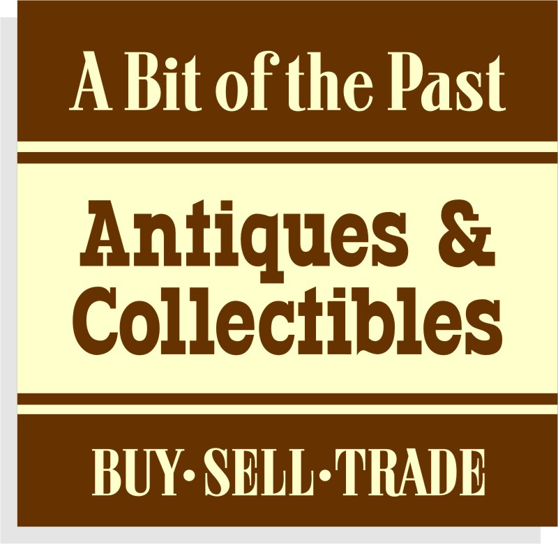

If everything in a layout has the same value, nothing stands out. Here is a quick suggestion using 100% free fonts and simple panels.
It is by no means portfolio material, but it does prioritize the copy.

Rick

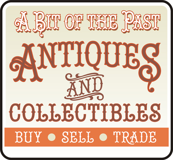

I did a layout too, but fisky does not want to play...
>walks away depressed<
Rick

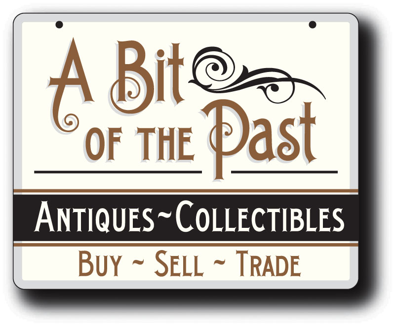

Okay I'll show you mine... but only cuz I saw yours!
I like "Billhead"
Billct2
These and Flames haircut signs are examples of what 5 minutes of applied skill can do for even the cheapest sign. I always say it is no more work to meak e a good looking effective design than a bad one if you have spent some time acquiring the skills and learning the lessons. I probably learned more about good quick design doing the cheapest of the cheap-paper signs.

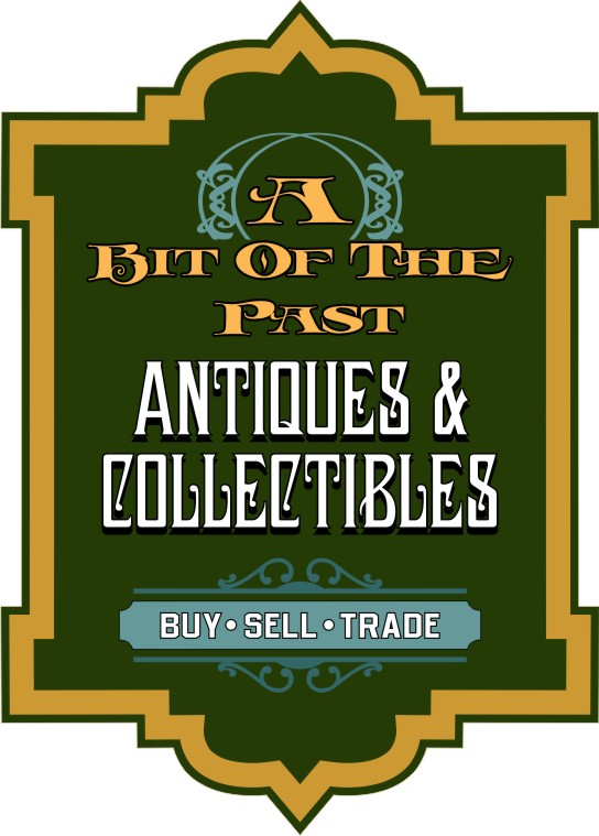

Ok, so I'm bored today and thought I'd toss one at you. Even though your customer is cheap at first glance, it may still be possible to upsell him if he's given other options.
I'm not saying you should design an upscale sign and hope that you can sell it to him on speculation but if you have better quality examples to show him in your portfolio, or better yet, actual samples in your showroom, you have a better chance of him deciding between basic or better?
There's a shiptload load of psychology that goes into selling and if you know what you're doing, you can get the customer to recognize the "value" in buying a better image for his business. Clients won't just hand out money but they will spend more if you give them a good enough reason why.
This is a design I just spent fifteen minutes coming up with, I timed myself. I have the tricks up my sleeve and use them every single day. Being able to come up with a good layout is no accident. This is why it's important for you to gain this knowledge. It will help your bottom line financially and plus, you will enjoy your work more if you can stretch your boundaries.
Just some more food for thought.

SignManiac
JR, I don't recall whether they were free or not but I have invested quite a bit in letterhead fonts over the years just for the reason this post is about.
You do what you have to do in order to get the job done the best way you can for the client. All three of these fonts were from Letterhead Fonts.
