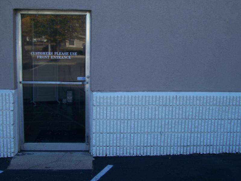

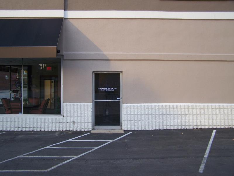

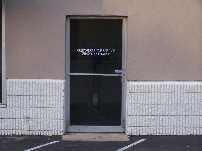

We are wanting to do window perf across this door here, to match the side of the building and kind of "hide" the door if you will. I don't know rather we're going to be better off taking a picture in the sun and printing that, or taking one in the shade. Ideas on what will match best? I would assume with the sun, but I figured I might as well see if anyone has had to match anything like this before.
The sunny version is always your best option. It is probalby closer to the natural appearance of the surrounding area.
jc1cell
My process would be a sunny picture of the wall, create several swatches with different tints of the picture color match and then compare with the actual wall and not rely only on the picture.
jc
rfulford
Shoot in the sunlight for sure. You will get your best color balance when shooting in daylight which is what your CCD or film if you prefer is balanced for. Also, your icc profiles in your printer are probably built for daylight viewing. The resulting image will match closer under daylight conditions and probably balance better as light changes. If you want to take and additional step, print a few color swatches, take them out to the site and evaluate them. You can adjust your photo as necessary to match colors you pick off your swatches.
iSign
is seeing out that window really critical? The window tiny peeking through will darken even a perfect color match, so you need to print lighter... or sell them on solid coverage!
TheSnowman
There's not much to "sell them on" since this is my shop...guess I should have said that. I will be subbing the print out, so not much chance for test prints. It's just something we wanted to try. We haven't done much with window perf before. There is a showroom in that door, and it lets in a lot of light, so we wanted to keep that around.
I will shoot in daylight, and then lighten it just a little more maybe, and see how it turns out. Like I said, just an idea we had, and we haven't done much with perf before. If it's horrible...I'll toss it.
