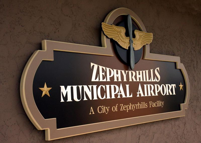

I use both methods, fasteners through face and blind install with VHB. I'm paranoid and prefer to use both methods whenever possible. I don't like putting screws through a sign face by themselves, but often hide them behind a graphic element like a star, diamond, or bullet so that you don't see the hardware. You can buy really nice plastic caps that snap over the screw, lag bolt, as well. I think they call them snap caps and you can paint them to match the background color.
On this sign, my tapcons are hidden beneath the stars as an example.
