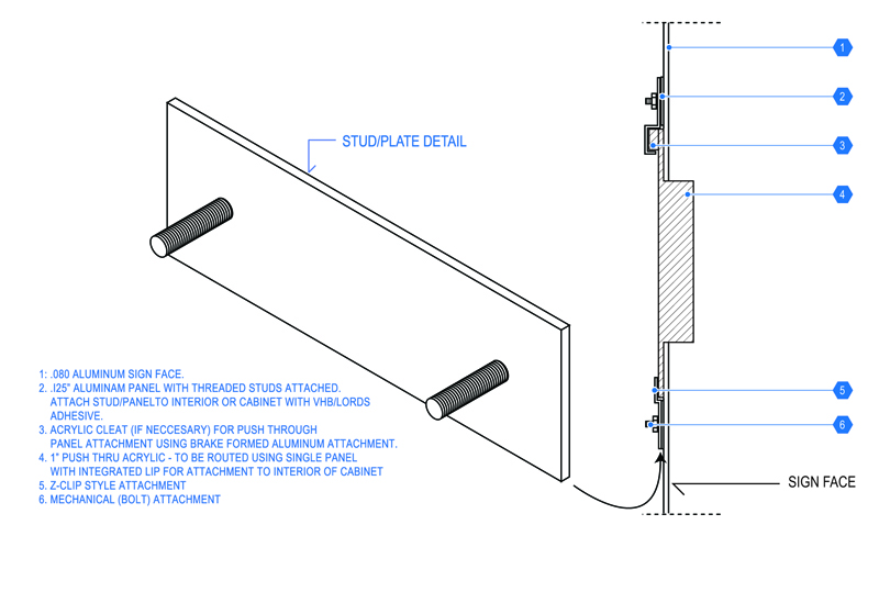

Rick
stud welds on interior. Ive seen it quite a few times to mech fasten a push-through mount.
I used to call out welded studs, but was never happy with the finish job done with the face distortion.
I started calling out this...
Welding studs to a panel, then using VHB/Lords and attaching panel/stud to the interior of the cabinet.
Then attaching push through with brake formed aluminum and bolt it down

For the most part:
There is no "standard" for fastening push thru and though I try to give every detail.
I have to allow the fabricator some allowance for how they fabricate a sign. I deal
with more fabricators than I care to think about. All have their own way... but...
during the initial construction meeting, this was called out as welded studs and
clip attachment using the method I prefer.
Most fabricators ignore my notes, but as long as I can take the letters out for servicing,
I don't care... but when something happens and someone has to remove the lettering
and find out the whole cabinet is trash if they try... well, thats unacceptable if we can
not find an alternate solution to re-finishing the sign.
If this sign never was jacked up, I never would have known... and I'm fine with that...
but when things get screwed up... own your part.
