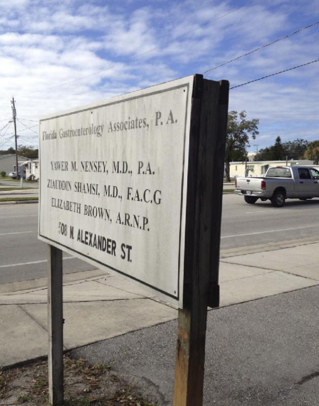

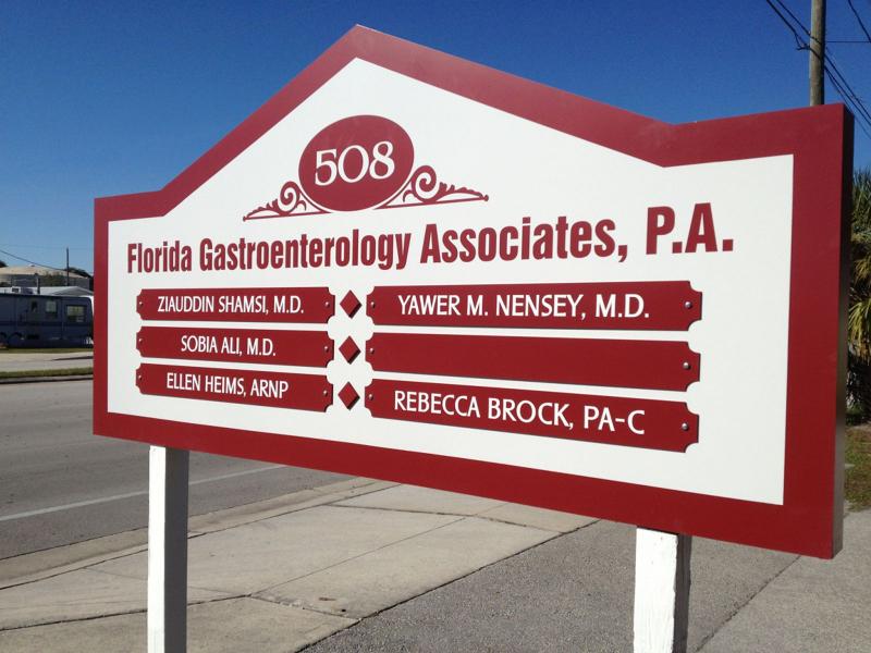

Doctors office called to see about a new sign to replace their existing one. This is not an elaborate sign but design wise, it's a vast improvement over what they had. 4'x8' on polymetal done in latex paint except for the names which are done in cast vinyl.

Never had any problems before, but I always scuff up the surface first with a scotch brite pad. Keep in mind, I'm using a reverse weeded paint mask and scuffing only the areas to be painted. Also I have since started using the premium latex with the primer already in it .. It cost a few bucks more but the savings in time and labor make up for the added expense.
SignManiac
I covered the ends with some scrap 3/4" pvc to make it appear closed in. Just a little extra detail to make the 1/8" polymetal look more substantial. The sign looks like its 4" thick.

the diamonds and name plates are those raised? if so what did you use? scrap polymetal?

Yes scrap poly for the panels and the diamonds are scrap 1/4" pvc with a very slight edge ease. I have tons of scraps laying around and use them every chance I can. Already bought and paid for! I have $90.00 worth of material in the sign, 10% of the final selling price.

ah the edge ease is where the shadow is coming from, nice attention to the subtle details!
