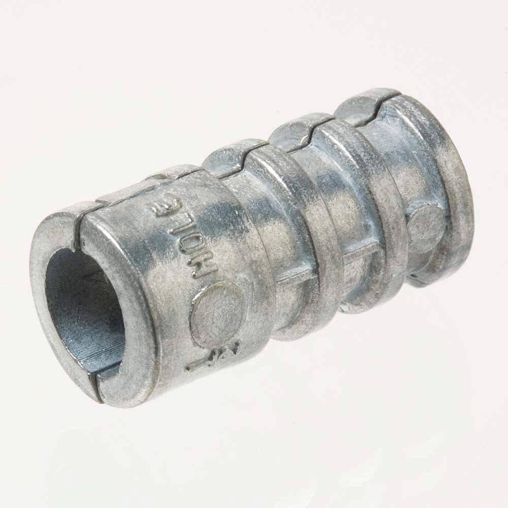

So the first image that nota posted we call lead anchors. They're great, but they need a tighter tolerance hole to work best. Limestone drills like sand, so I'd opt for the second picture nota shared, what we call a shield, used with a lag bolt, it will nearly double in size by the time it's fully set. That being said, you need to avoid using too long of a lag, or it will blow out the stone when the anchor expands too much. For a projecting sign, I'd also add guy wires to keep the sway of the sign from wiggling the bracket if it's a swinging sign, or to just take windload off the bracket if its rigid.

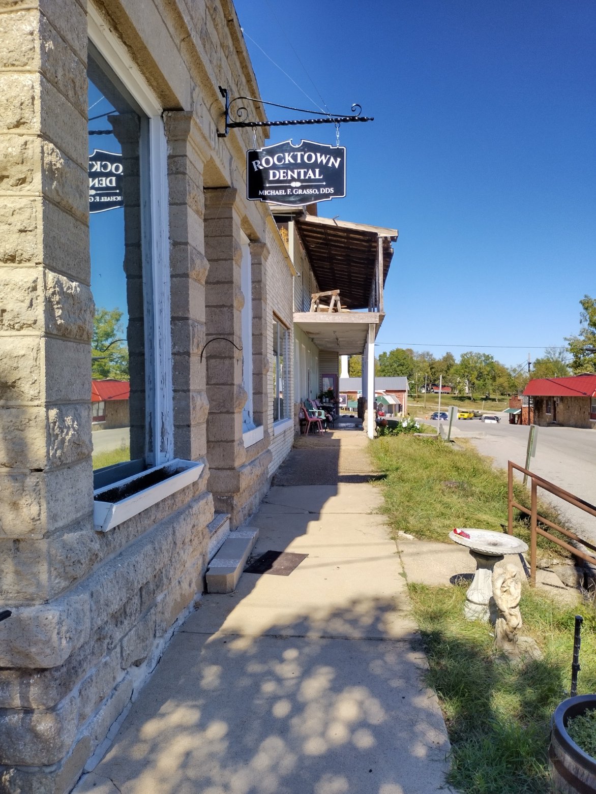

I have already had a mounting bracket made that spreads out wider than the baseplate of the sign hanger, and we are going to use the guy wire attachments that were used with the old 4'x6' electric sign that used to hang here.

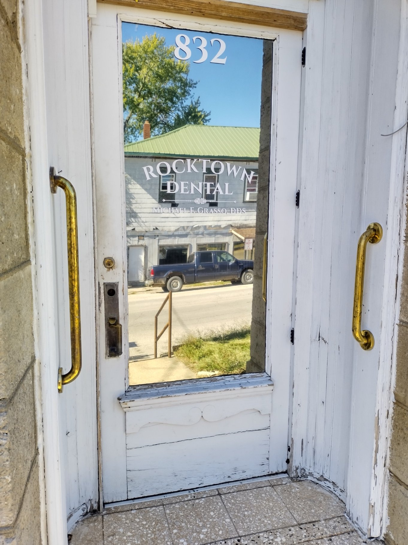

very nice sign job, but a coat of paint on the owner's part wouldn't be the worst thing in the world
realtors tell you, when buying a house, the condition of the front door is most important.
the door area could have been spruced up with one of those $2.99 sample color match cans from home depot

A few things UncleBun. Lags and shields are all anyone used years ago before tapcons came around and you did a great job. I have restored old sandstone installs where the original install used pieces of wood jammed in the hole and screw inserted to expand wood to hole. I like the old bank with the used old doorway. Needs the cracked glass repaired also.

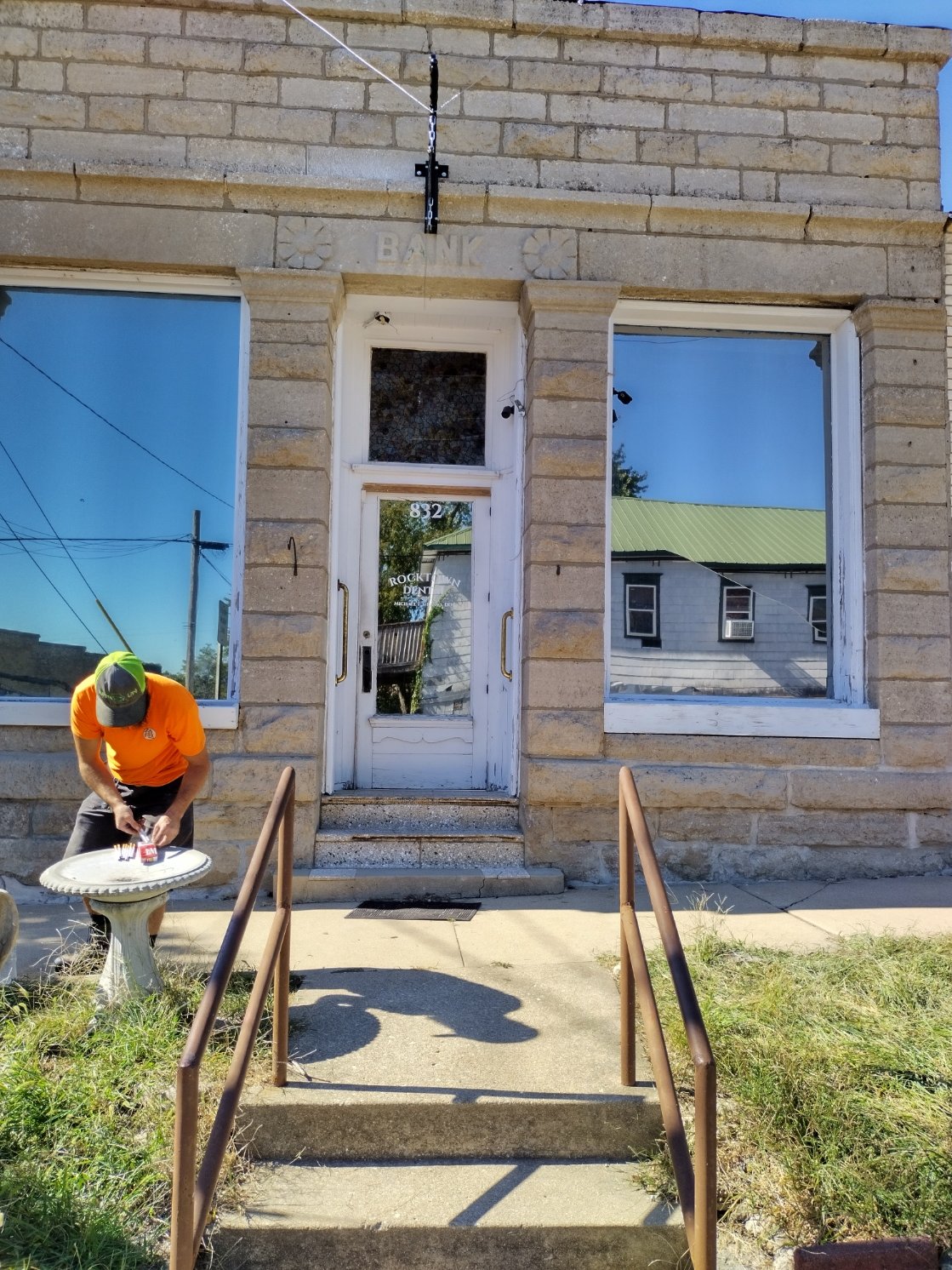

The thing that is curious to me is the guy packing all the cigarettes up at the birdbath.
Yeah, and tell them to put a doorknob in the door. They work better that way.

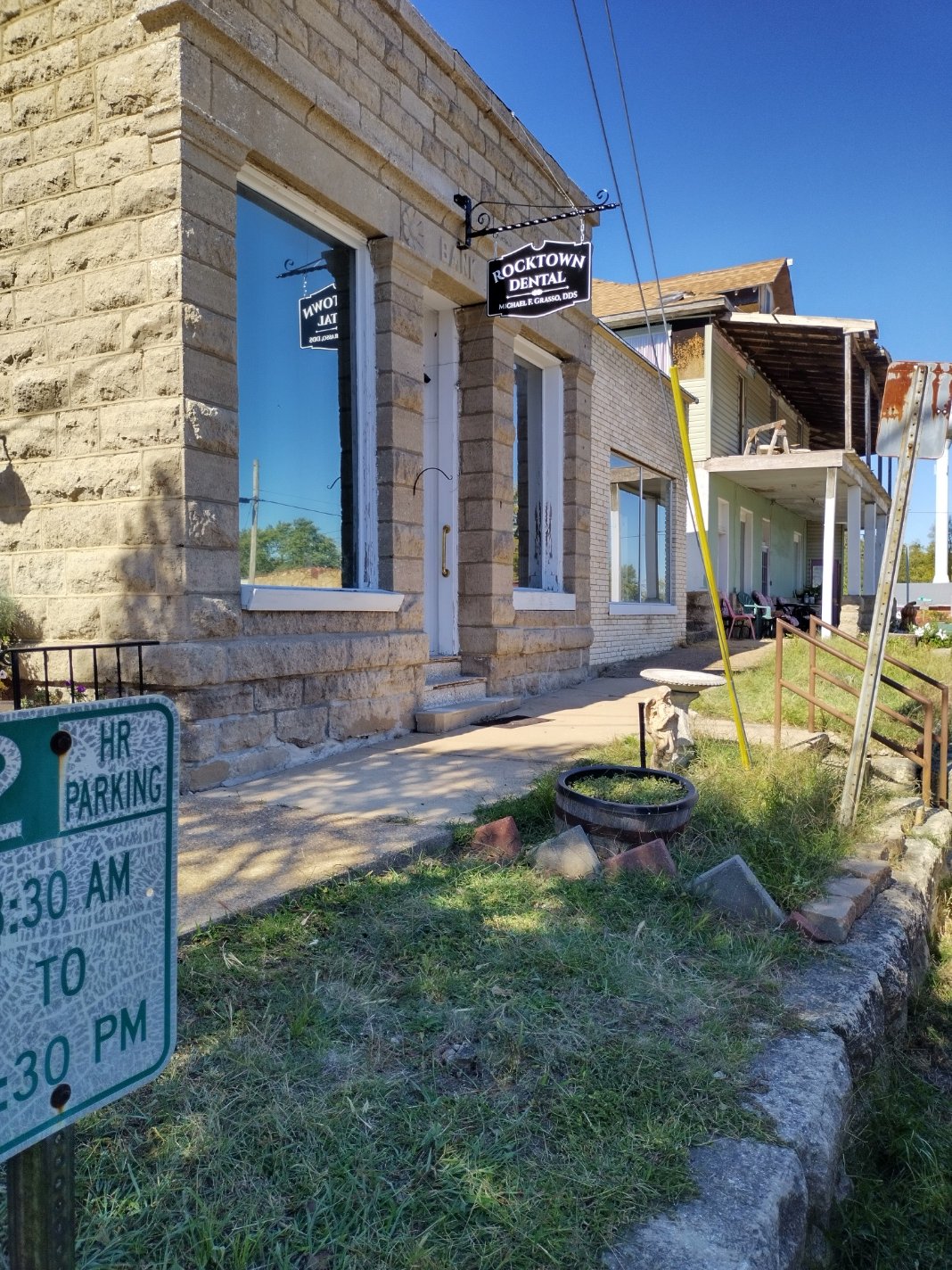

Nice job on the sign.
