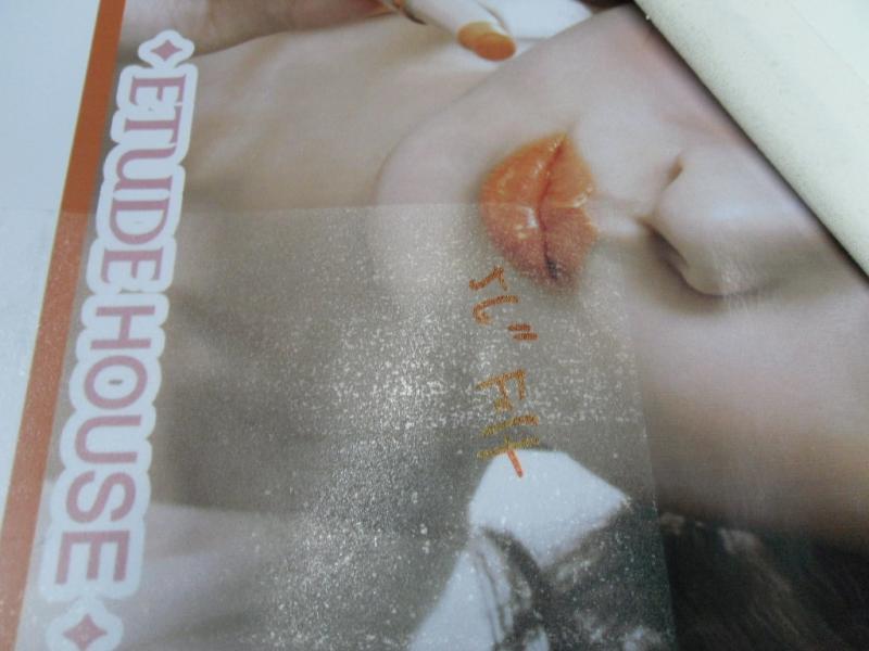

kffernandez
here's a pic of my matte lamination. please forgive the quality of the print and the picture.
you'd notice that the lower half is a bit better than the upper half. i manually squeegee'd the lower half to get that result. if i were to do my usual wet install on my lamination here, there will be no discoloration whatsoever.
so, is this the usual silvering that supposed to go away tom? or am i going about this wrong somehow?

Jack Knight1979
Looks like silvering. Everything I lam with the BS has this for about a day and then looks perfect.
If it's staying longer than a day you need to apply more pressure.
I also hand squeegee everything I run with the BS to ensure even contact between the laminate and the print.
thanks jack! that was exactly what i was hoping for.
tho i was wondering about your hand squeegee step. i noticed that when i hand squeegee it right after running it through the BS, it had a tendency to produce a few very small bubbles. have you encountered that scenario? or will it go away soon enough as well?
kelly
Jack Knight1979
That's the reason I hand squeegee. Sometimes I will get some smaller bubbles after that step. The smaller ones will dissipate in a day or so. Bigger ones will take longer, so usually pop any larger ones. The micro ones I leave alone.
Micro bubbles will go away. Any bubble that makes a dome shape like an actual bubble must be popped in most cases.

+1 silvering
little heat during application takes this right out... or even prior to application if you're careful not to destroy your graphic with too much heat.

Yep, Silvering goes away after a day or two. I was too concerned when i first started seeing it.
When i use oracal gloss laminate it takes about a day, day and half and when i use a luster 3m laminate it takes about a day. I find it best to contour cut after the silvering has gone away for best results.
I'd think a matte lam would maybe take more time, not sure.
I laminate, roll up with print on outside, and store it until a day or two then i contour cut and send to customer. Don't squeegee after laminating, Just laminate, roll up or leave flat and wait.

From the picture that was posted, someone's concept of silvering is radically different from my own. Those are bubbles.
With the Big Squeegee those usually are caused by lack of uniform pressure across the entire squeegee. Often the result of trying to push the squeegee with one hand while you wrangle the backing with the other. With two hands it's a whole hell of a lot easier to maintain the requisite constant pressure.
Try the double-faced tape solution as seen on You Tube. Once you get the hang of it it works perfectly, no bubbles and minimal silvering.

The double sided tape is to lift up the leading edge and to pull the backing off ahead of the squeegee. The tight roll keeps the backing coming off ahead of the tool.
Some bubbles may be from trying too hard. Never twist the tools to get more pressure. It is better to raise the back up to get more downward pressure.

Although I will say it might dissapate over time it has a lot to do with the actual laminate itself. there are so many different types out there. Some take longer to smooth out.
I ran some large prints about a year ago and used the big squeegee and DRYTAC laminate. Everything looked good when they went down with the usual haze that goes away, but the next day the haze looked more like bubbles and lots of them. The prints were ruined in my eyes and I wrestled with them trying heat guns, laying them outside in the sun...anything to avoid reprinting. After 3 days I knew I had to reprint. I figured I had not used enough pressure with the BS and ruined them.
I reprinted and used a different laminate and they went out fine.
The original prints I saved, and left them in the back shop as it made me sick to think i would throw out so much printed vinyl. After about a month I had to move them somewhere else and I grabbed the rolls and casually looked at them.
They were perfect!!! there was not a bubble to be seen and I started looking through them all and all were mint. Naturally i called the client and told them I had 10 prints here if they needed them and could offer them a good price.
Damn things are still here as I wait for the next order lol
