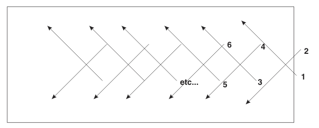

+1 for wet - also, when applying, I use a herringbone-type pattern with my squeegee - observe:
