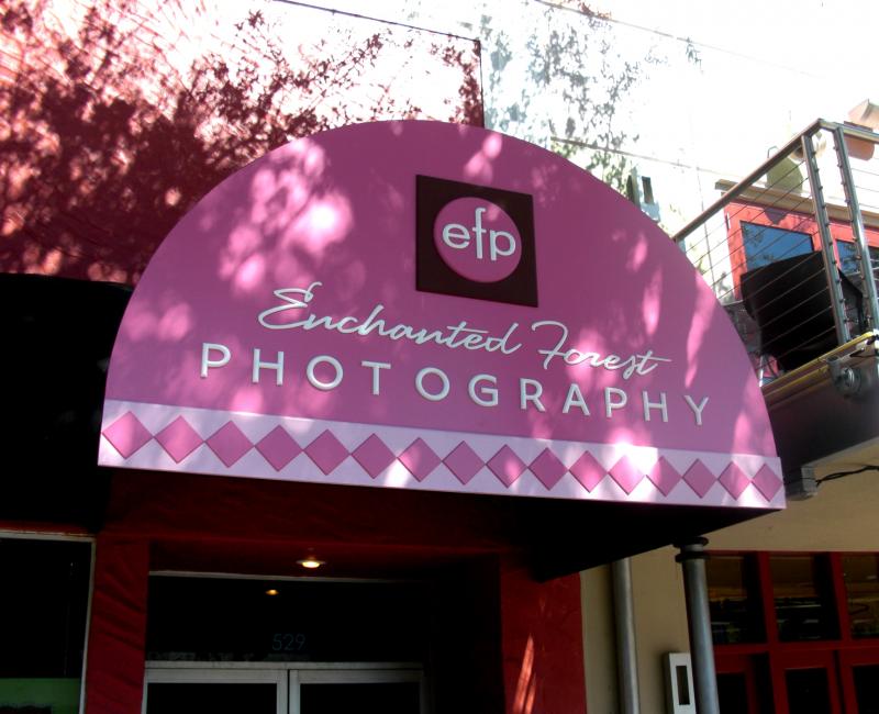

We just did this awning with arlon 6000xrp
it stuck fine, we did this job for a awning company down the street, they usually use a gerber edge to do the awning graphics using 3m vinyl but this job was bigger than the 12" they can do with the edge.

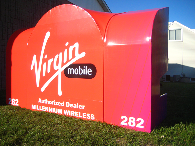

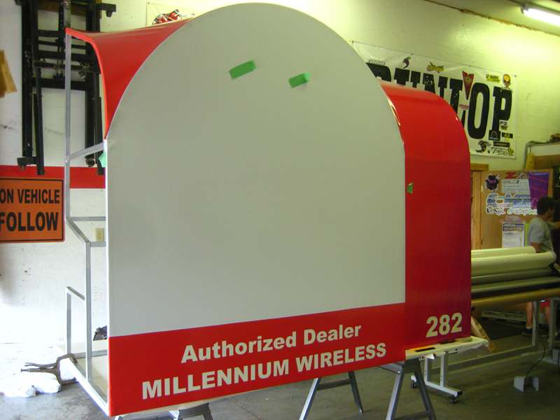

SignManiac
I made a 3D awning out of Dibond a couple of years ago. See if you can up-sell them? Paint is another way.
