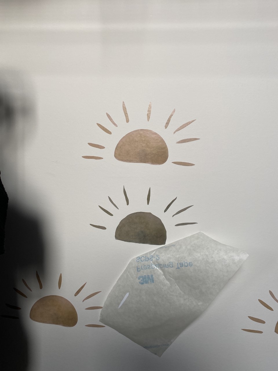

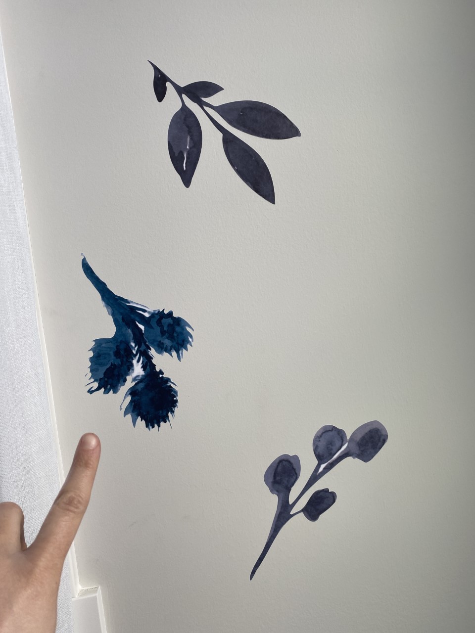

I am attaching some photos of our variance in colors from another shop that I had print them who uses a roland with canned profiles, and it is insanely different. The roland is outputting color that is very close to what you would expect, and ours is just outputting literal poop.
On the sun decal, mimaki output is dark crappy looking one.
On the blue decal, the mimaki output isthe one being pointed to.

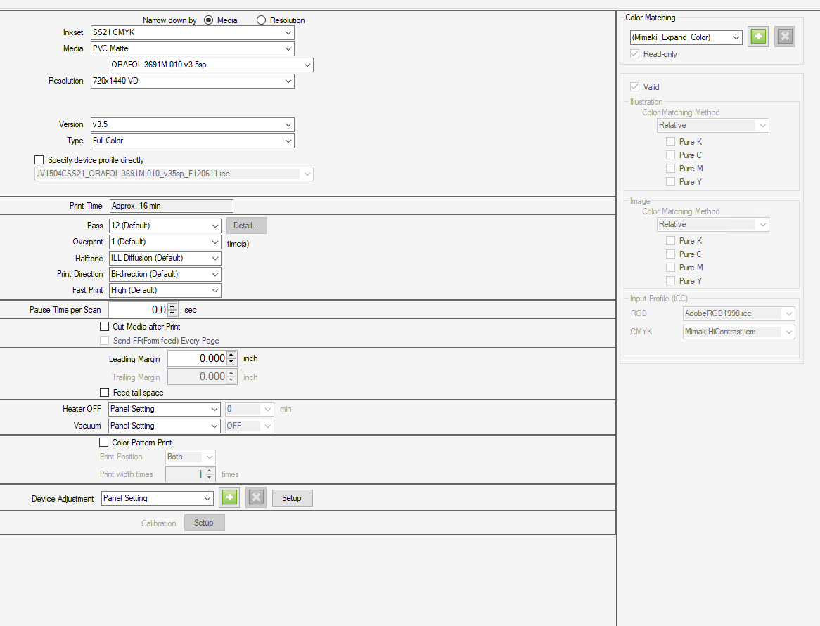

If you can, take a screenshot of your profile settings page on one of those jobs. We might be able to spot a setting out of place.
Here you go!
On this one, I am using the mimaki expand color (which sometimes seems to get us a tad closer) but realistically both the default and the expand color are out to lunch.
On some projects it seems to be acceptable, but on the photos I posted earlier for example its horrific.
I dont know what to do at this point. Hopefully this helps.

That all looks pretty standard to me. If you want to upload the file I can print it out on my CJV150 I have in the shop and see if the output is any better.

View attachment 157257 View attachment 157258
