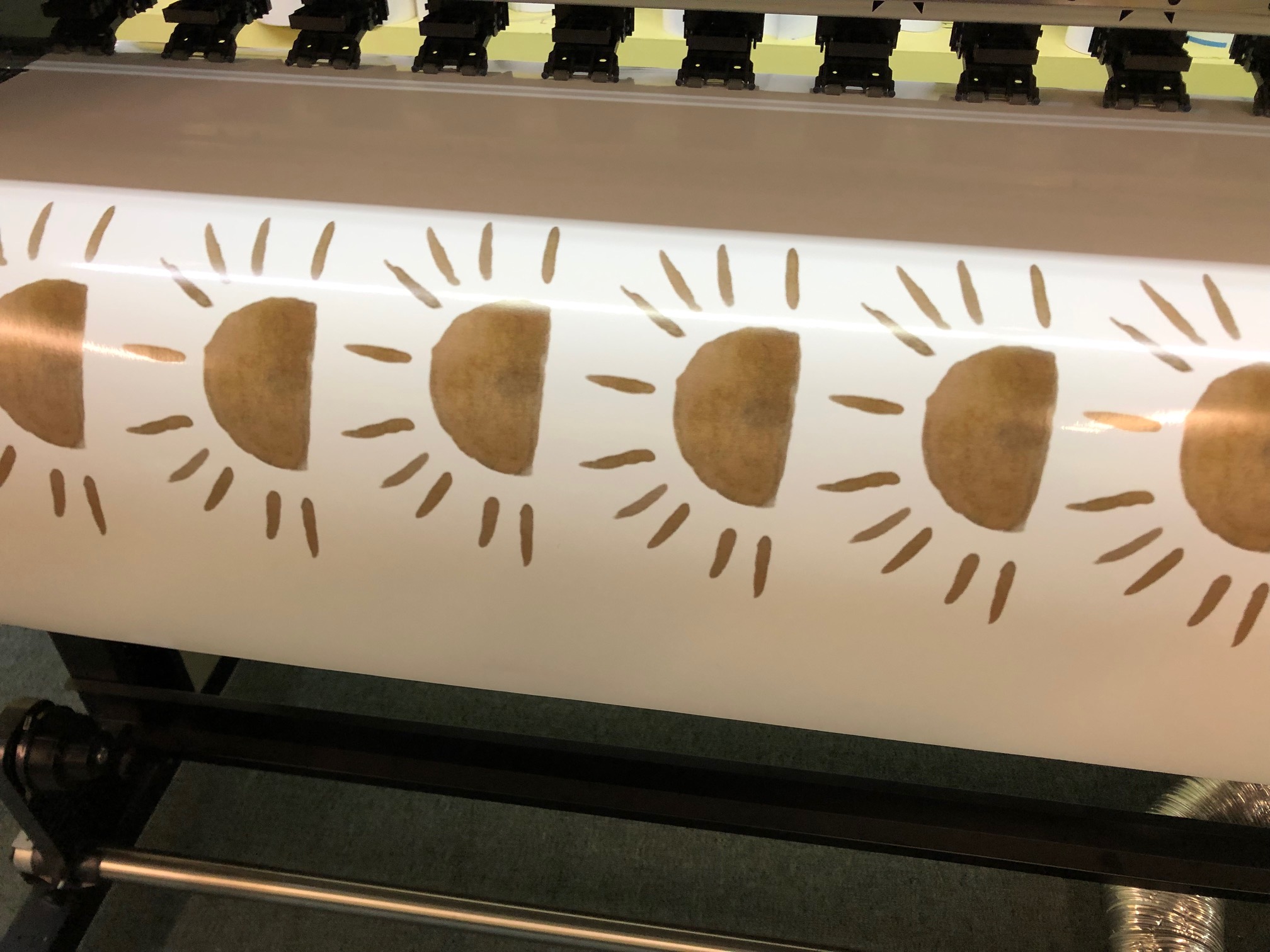

The image is pretty low res and I broke the masks down so that I could print one line of them for you. Not sure what colour it should be but it sort of has a goldy brown look. IMG_2055.jpg File attached
johnb554
The image is pretty low res and I broke the masks down so that I could print one line of them for you. Not sure what colour it should be but it sort of has a goldy brown look. View attachment 157289 File attached
I would say that looks about right!

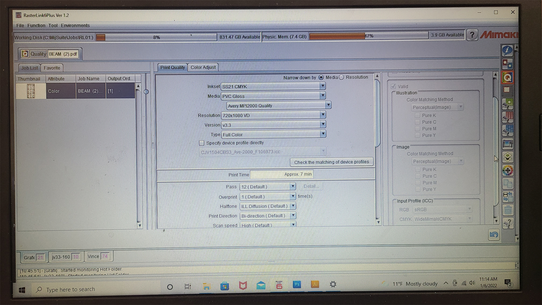

Solventinkjet
DIY Printer Fixing Guide
Sorry I was called out on a service call yesterday. Here's a screenshot of the settings I used to print the image circled in green.
