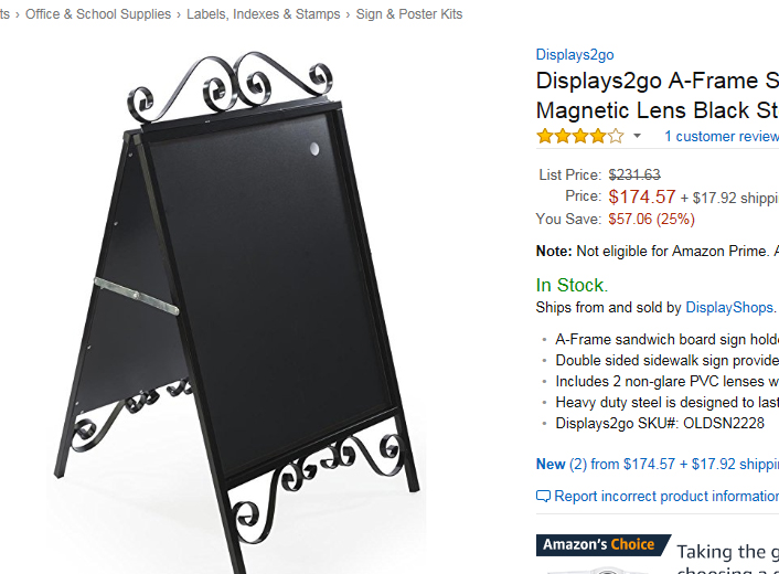

21 x 34 A-frame Chalkboard, Black Wet Erase Surface, Removable Boards, 2 Sided, Black

Go to a company like "Displays2go" and look under restaurant signs. There are lots of higher end sandwich signs. they are usually dry erase or chalk, we just go right over that with either a print or a print on pvc.

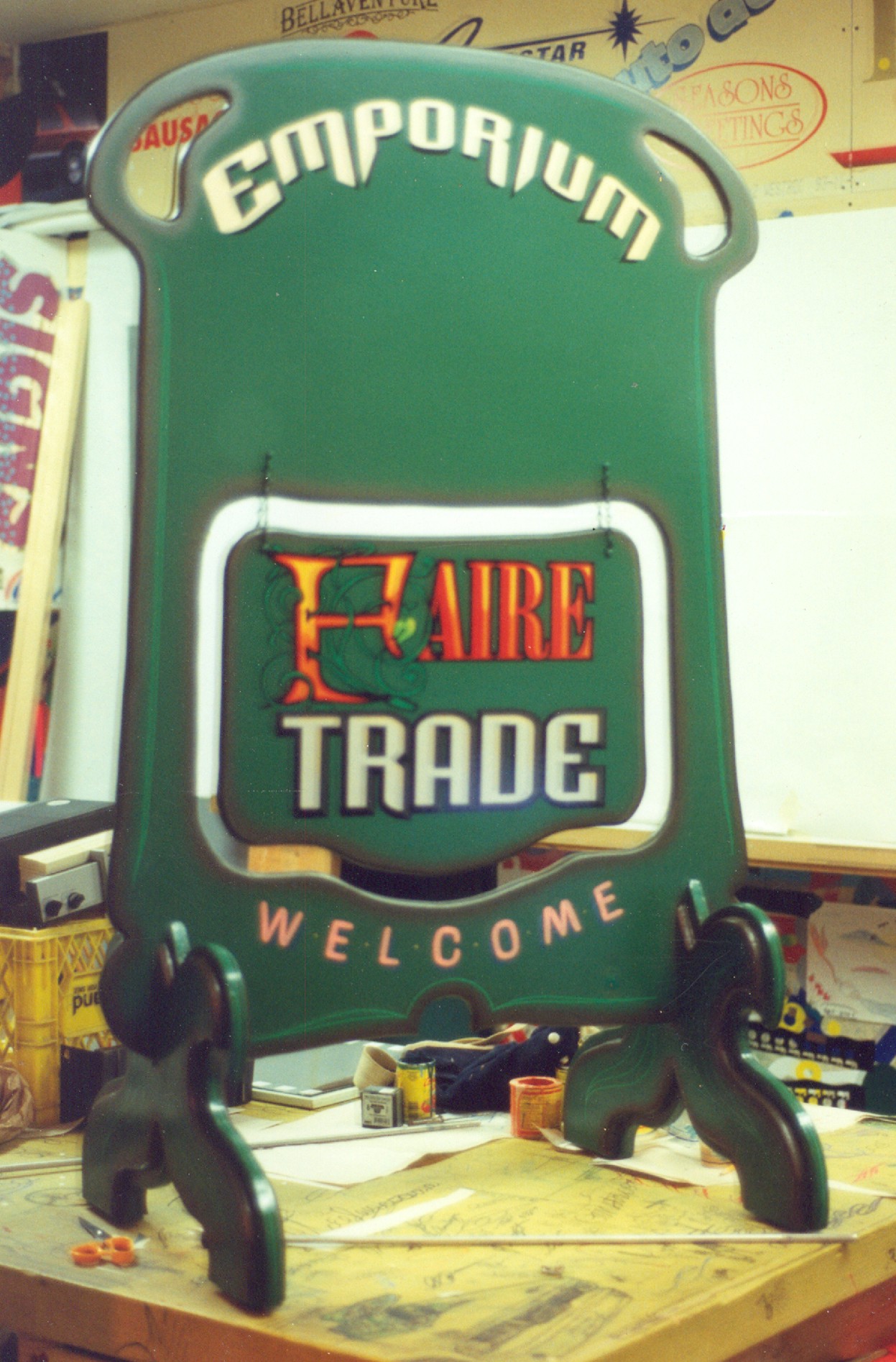

The picture is a little blurry, and the sign isn't finished in the pic, but here is an option we did for a client who wanted something a little classier than a plastic A frame.

Thanks for the kind comments. It is just 3/4" Crezon MDO jigsawn to shape and fitted to the bases with slots. Weldbond glue or gorrilla glue to hold together. General Paint Marine enamel for the background, airbrushed highlights, HP cast vinyl lettering and a bit of old school striping for a border. A pictorial of an antique sewing machine filled in the centre portions. It's too long ago to remember what I charged, but I've always been fair to my clients. Probably around $500, maybe less....
