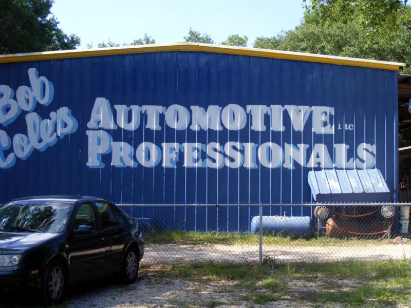

i have done 10 foot tall, 40 foot long painted lettering on the sides of buildings......i have done it with a POUNCE PATTERN, OPAQUE PROJECTION, and just using a straight edge and measurements..........less time: involved if you just straight edge it and measure.!!!!! here is the latest one we have done and was a POUNCE PATTERN. i think that wall is 14 foot x 40 foot.

i honestly have to say..........you may not like it, BUT this is the kinda job us old SIGNPAINTERS are used to doing. something like this and some "natural art talent," this is what we considered a KNOCKOUT JOB.... because of its size, nothing has to be perfectly placed, or perfectly laid out.....you have a little "artistic freedom" doing these jobs. as i showed you the example of the 14 foot X 40 foot metal building wall, all from pounce pattern. the bob & cole, was drawn on paper by the plotter at full scale. the PERFORMANCE was also drawn from plotter with a pen instead of the blade. the same with AUTOMOTIVE. you do notice the building has ridges. the pattern for each word was taped to building, on the high ridges....the lower part WAS DRAWN in as we painted it. less then 6 hours......from start of painting till finished and it also had a drop shadow))))
i also have to say the picture is taken couple months ago..........the SIGN WAS DONE 5 YEARS AGO....the drop shadow was process blue...against the dark blue background and it really "popped!!!" iam not sure but i think we got $2200.00 for this...

with the dark blue background.....process blue shadow white lettering. the picture is recent, like may/june 2013............the actual job was done in 2008-2009!!!! so the brightness of the process blue has faded.........i know what your saying about shadows....but we took a little "artistic freedom"hehehehehehehehehe
ther also was another word ABOVE the AUTOMOTIVE, dont rememeber what it was...
