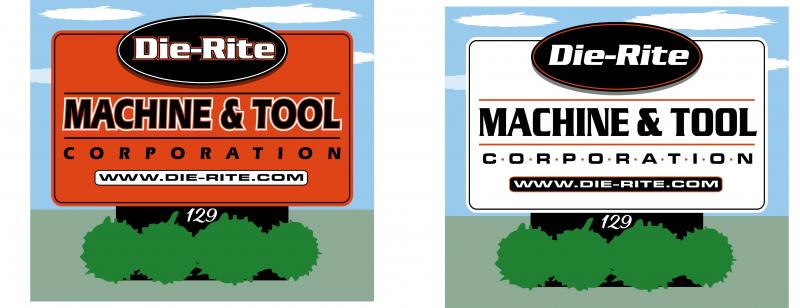

Doing a design for a customer. Any help would be appreciated. I think I am on the right track, but came here for professional help. Let me know what you think. The customer wanted orange and black so this is what I came up with...thanks

You might get more help after you introduce yourself...
A few questions:
Is that the existing logo?
Double or Single Sided?
Is that oval dimensional?
Is that an existing sign that is being refurbished? or a new monument?
How big?
Illuminated or non-illuminated?
---Too many typefaces, I count 4
---The typefaces being used are too "signshop" These typefaces are overused, and typical of the sign shop look, I believe there are better typefaces that just running to the typical typefaces that were stuck in an old Gerber 4b
---Typefaces with a slight slant are distracting to the eye, it's neither here nor there, better to use a non-oblique typeface in this situation.
---CORPORATION kerning needs work
---Color, maybe we are too close to Halloween, but throw a pumpkin on that thing and they are ready for trick or treaters. I would look at a dark blue instead of black or add some metallic silver paint color.
---Lose the outlines.
SignManiac
Everything Rick said, and the colors don't work the way you are using them even though the client who is not qualified, specified them.

You'll get better replies if you post a jpg rather than a pdf.
I would use different fonts, Eras is getting dated looking. Even if you used a clean gothic style for corporation. Everything is run too close to the edges as well.

Ok....here it is revised. The sign is a old client with new colors. We did his existing sign 12 yrs ago and was wanting to replace it (old/faded) with his "new" colors. The top oval would be a 1/2" separate piece on top of the main sign. Thanks for the suggestions. I was worried about the orange fading faster than a lighter color....I welcome ANY suggestions.......Todd
1 on the left is original...right, new design

I like the new colors but really hate the dots between each letter as that is dated and looks old plus there are so many letters in the word that it just clutters it up.

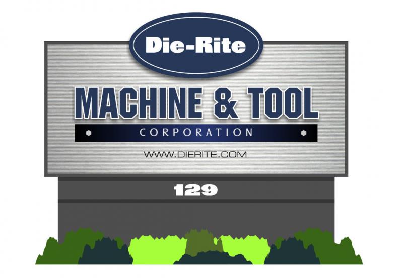

None or your designs say machine or tools to me in any way. I'd go with a more mechanical feel with color and font choices. Here's my take on tweaking your format. If it were me, I would even scratch your existing layout and go for something entirely different.

now that says machine and tool! very nice!
All the way........... :thumb:
I also presume, your indicating of shadows, is not for a digital print, but a relief sign as well. Really makes the sign become sturdy and strong looking.
SignManiac
Gino you are correct. Besides, everyone here knows I don't know how to make flat signs :)
Also I should point out, I broke the rules and used four different fonts...
SignManiac
Never said I could count Rick :)
Okay you got me. I did use only four. Die Rite and the address number are the same font!
