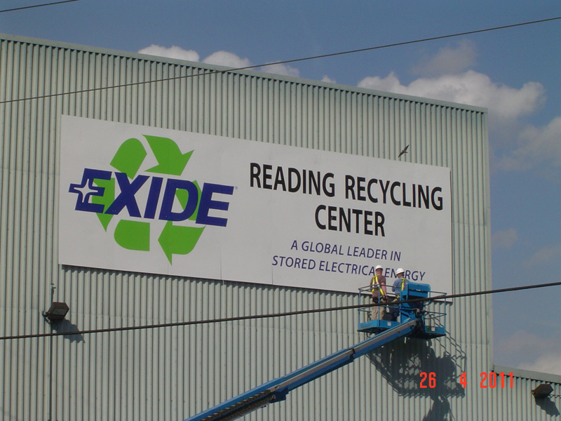

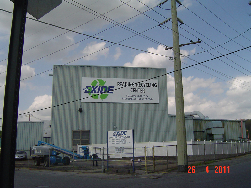

Round man's right on the money.
We do quite a few signs in the 10' x 16' range to 12' x 32' range. Doing them since the mid 80's. The average viewing distance is 400' or more. Much under 8" or 9" is almost wasted time and space.
The three second rule is a very good one to see what they remember in a glance.
Granted, we have lotsa people breaking that rule and when they come back and say.... I can't read that stuff..... just refer back to what you originally told them.
We just put up a 12.5' x 39' yesterday, I told them they have too much on the sign and they said that's Okay, we want it there. The End.

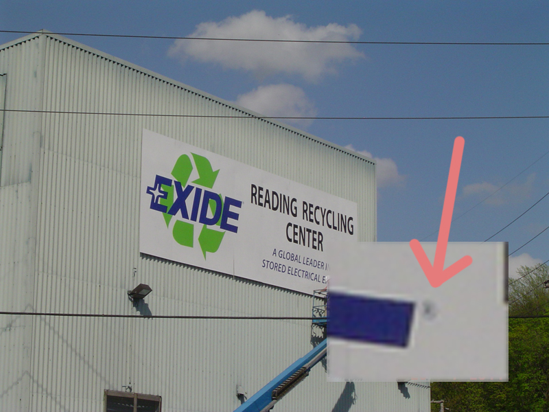

Here are two pictures. The one is taken at about 425' away. The smallest copy is a foot. The other is for reference of how tall a letter is up close. That one was taken at about 200'
By the way, that sign is completely hand painted from pounce patterns.
See the ® behind the word Exide ?? That's 4-1/2" tall.

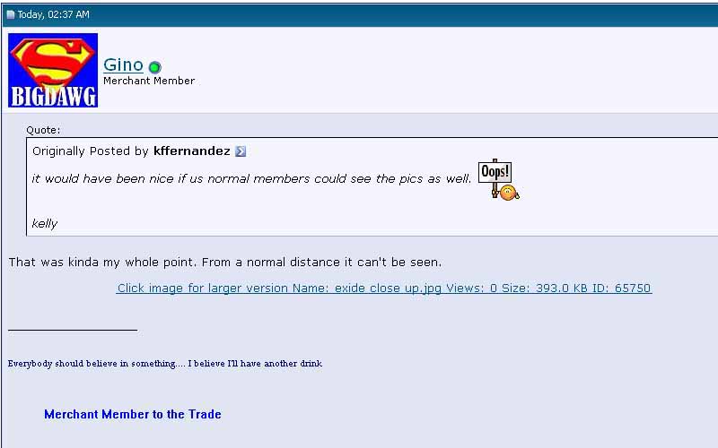

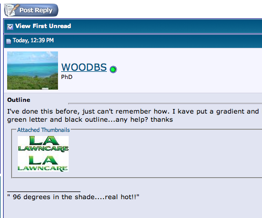

My guess is that they cannot see your embedded images. I cannot see them either and it has been this way forever. Works ok on Safari, but not on Chrome
For some reason, both you and Joe Diaz are 2 members in which I cannot see your images. There are others but I can only think of Joe's right now. How are you attaching your images and why do they not say "attached thumbnails" and shown below in their own box? I am showing 2 examples below of how your's and Joe's are different
I save it as an 800 x 800 jpeg and hit the attachments clip and it puts it right in there.
I know others have some difficulty, but Fred would have to explain it again. I don't believe I or Joe are doing anything out of the ordinary, but perhaps the software you use is not allowing you somehow to see them.
This was just discussed in a thread within the last few weeks and I thought you were involved in it. Many here saw what was causing this. It didn't effect me, so I didn't really pay attention to the outcome.
Perhaps, Fred or someone can explain this again or maybe we can make one of those sticky notes and always point people towards that when confronted with this problem.

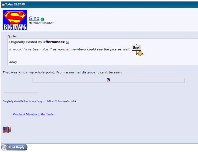

yep. i'm unable to see the embedded images. with my firefox, it does show the link, but there isn't any thumbnail. clicking on it throws me to a login screen that says i don't have permission to access the file. i just assumed that it was a premium subscriber thing.
btw, i do actually see other people's attachments. :signs101:
