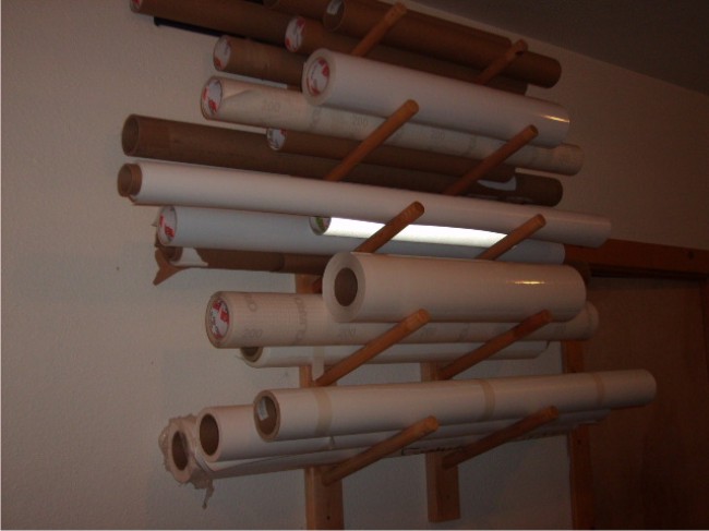

You mean to hold your rolls of paper, vinyl etc?
I built my own. Check out this pic of one of them. Just screw them into the wall and they worked out nicely. I originally made them to hold the rolls on each dowell sticking out, but I found I could hold a lot more by simply putting two close together and rolling the media into each slot I formed (if that makes sense).
I can give you dimensions too if you want.

Downside to what youre doing there is putting a Dent where the material sits on the wooden dowels. I know most come in boxes...BUT if you have larger diameter tubes, cut the tubes lengthwise and place the substrates in the clamshell of the tube. Prevents the denting that can cause headstrikes and all.

I'm in a tight space at the moment and don't have too much of a choice. I have over a hundred rolls, and I'm working in 400 Sq. ft.
BUT... I haven't really experienced any denting to be perfectly honest. Maybe because I use all of the rolls a lot and they don't sit in one spot for more than a week or so, but I've never had any issues with denting and/ or headstrike.

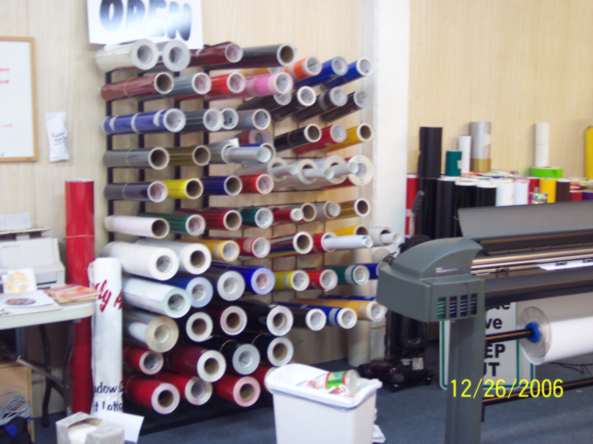

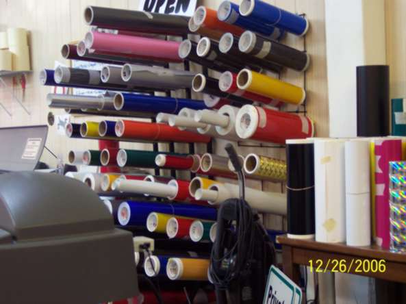

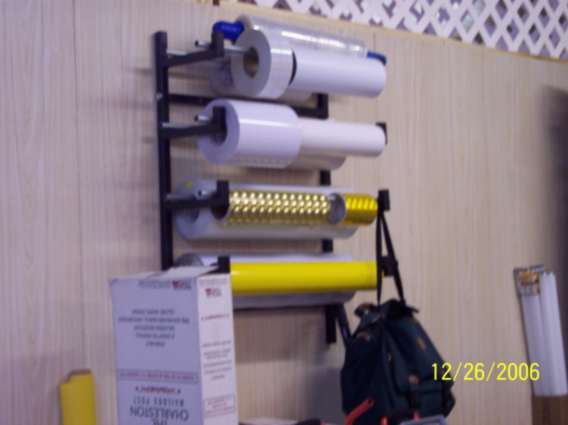

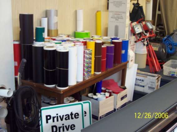

I use the same rack Replicator does. I also have 2 small 16 roll holders mounted on the wall, one on top of the other. As for smaller 12 or 15 inch rolls they are on a table. I keep my heavier material, magnets and such on a heavy duty rack.
I attached a few pics

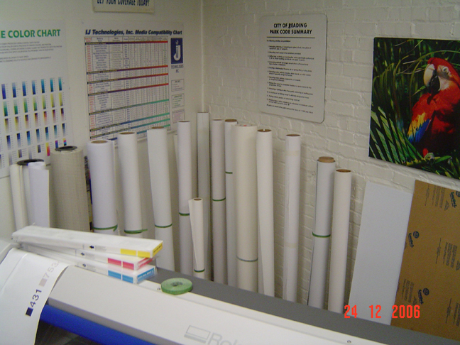

Well if something isnt sitting for that long then its great. I get rolls of material that I have to stock and it might see the light of day once every 3 weeks if im lucky. Also Im using rolls that are quite heavy...upwards of 100#'s or more. All my smaller media stands vertical against a wall behind my printer.

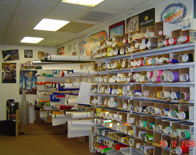

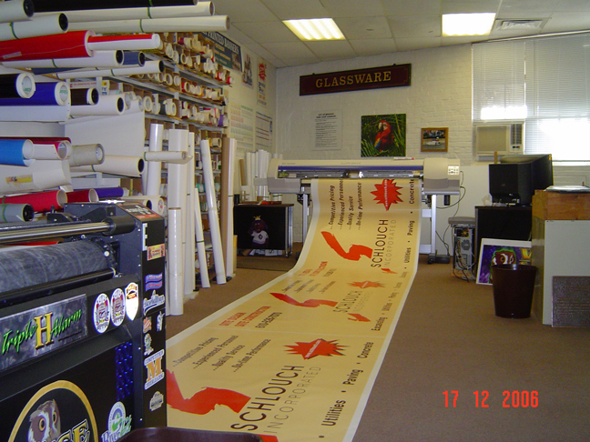

Here’s some pictures from two angles and one in the middle of last week while stuff is lying around everywhere.
We’re the same way, little rolls [15” & 30”] won’t get hurt while lying on their side, but those bigger rolls get flat spots in them even after sitting for a day or two. Then the ink lays down differently and gives a slanted look to those spots or indentations. I’d never store any 54” roll of anything on its side like that.
Hope this helps...
