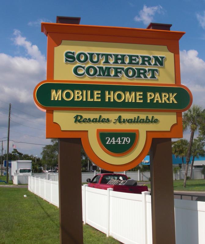

I posted a partial shot of this sign last week before it was finished showing a before and after. Here it is all done. I keep getting ideas in my head.

Is it all pieces of HDU on top of each other? The prismatic lettering at the top looks awesome. I am doing a sign right now with some crown molding like that, it really adds to the sign.

Thanks everyone. And Kevin, I didn't use any hdu in this particular sign at all. It's made from multiple layers of PVC, Azek Frontier board, and the crown moulding is solid PVC from Home Depot. The prismatic letters were made from 3/4" PVC as well.
The nice thing about PVC is that you can weld it together with cement and build your strength from the layers. It works down here great but I might think differently using it up north with the extreme cold winter conditions. It can get cold and shatter like glass. Lucky I live down here :)
