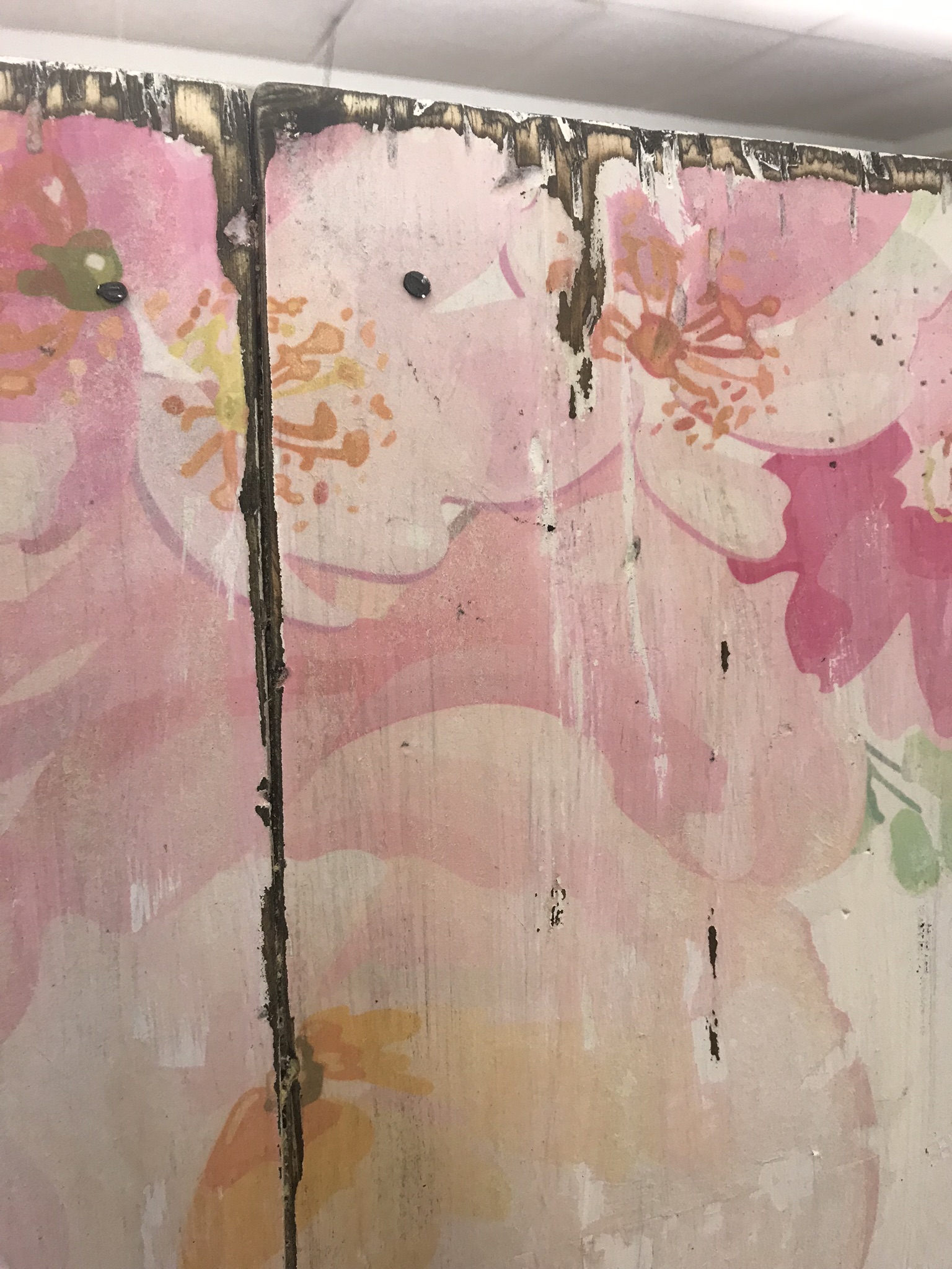

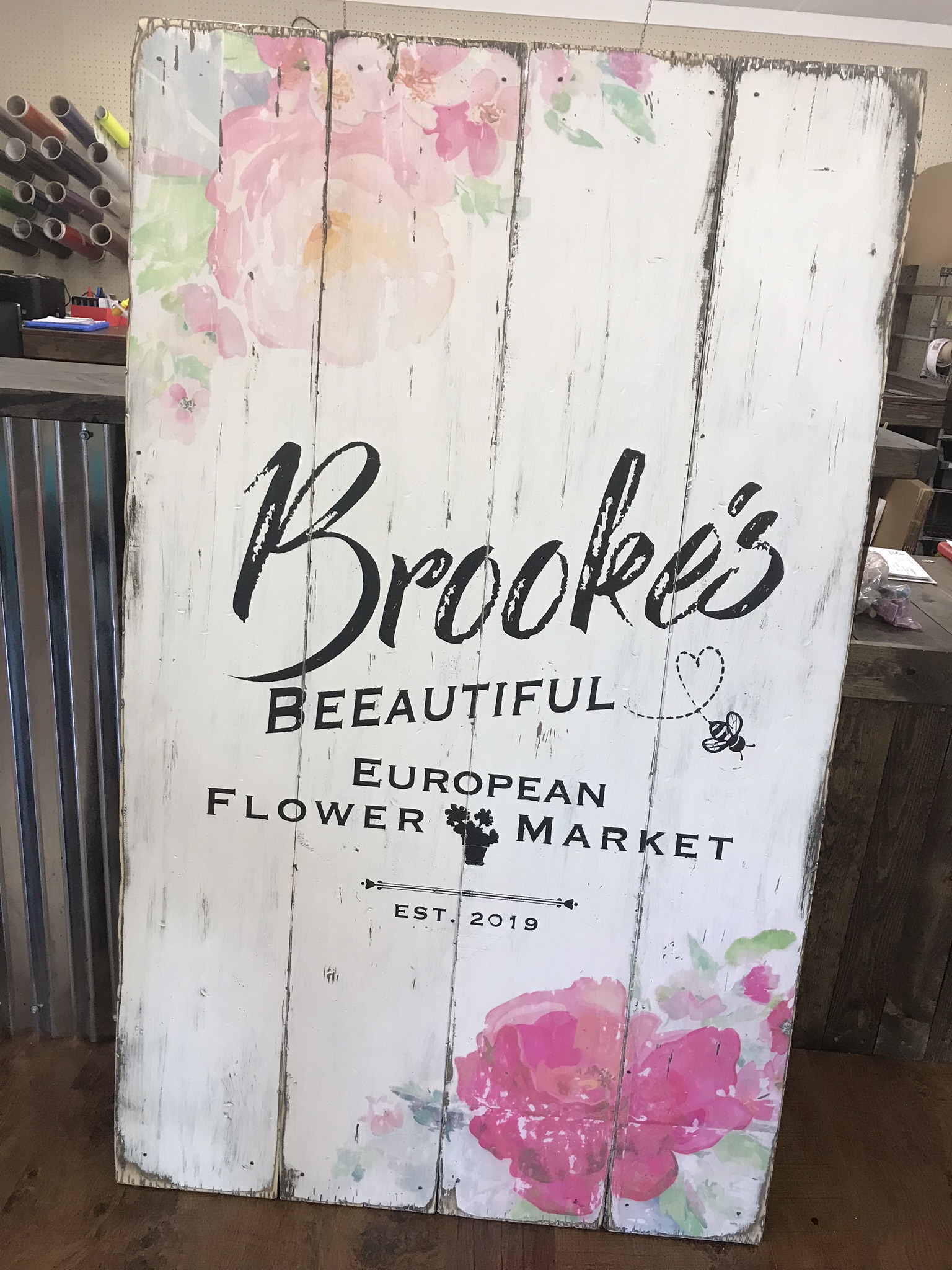

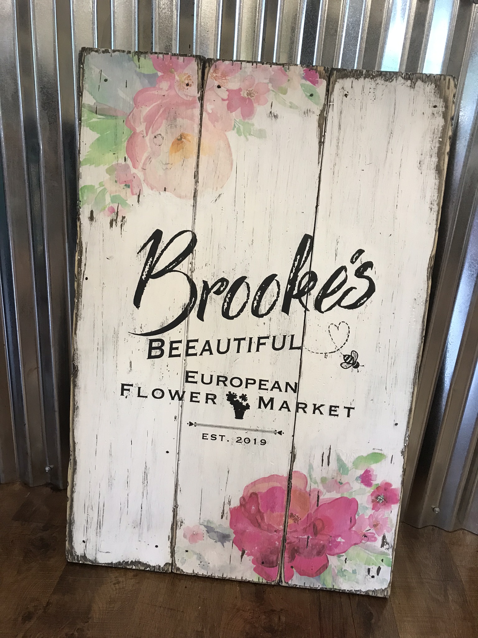

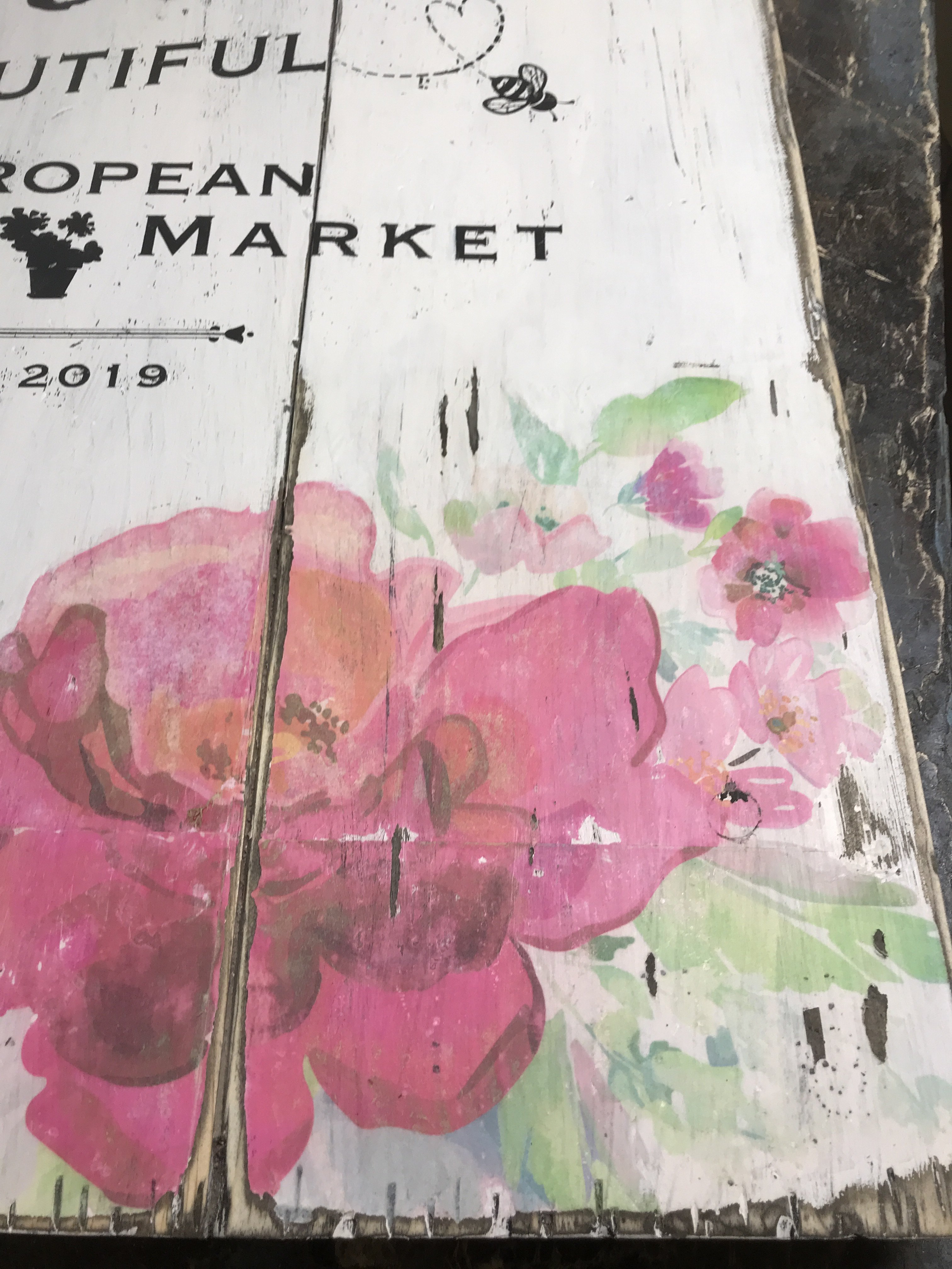

Some of you may know on the side I make hand painted wood signs. I wanted to share a pic of one I finished up yesterday as I think it turned out pretty good. I made 2 and they are temporary signs just for the weekend, sized at 5'x36" and 24"x36". I know some of you make hand painted signs so thought this might be of interest. I used Modge Podge on it, something I've never used before. This request came from a large client for a wedding this coming weekend so don't share the photos! LOL The graphic designer sent me a PDF of the artwork. I printed the flowers tile style on my printer and used modge podge to apply to the sign. I cut a stencil using stencil mask and painted the wording. I used new pine boards, roughed them up and then sanded and sealed everything real good after completion. I add black carpet tacks to look like old nails. These were fun signs to make and gave me great satisfaction, not an every day occurrence! LOL

Thanks Gino, the process is different. For the Modge Podge you reverse your image when you print it. Apply the modge podge to the image then lay it image side down on the substrate. Let the modge podge dry completely, then spray the paper with water and gently remove the paper. The image stays on the substrate while the paper is removed. It's rather messy and tedious but gives nice results. I was quite surprised the colors were as vibrant on the wood as they were when printed.

Your aging process on the wood is very effective. If those were new boards I wouldn't be able to tell from the photo. I would have guessed you found some old boards to work with. Nice job! I like the contrast created by the stencil painting too. The letters don't look hand painted, but I think that's ok. It draws attention to the text which helps to balance the images. One suggestion. I would replaced the A with a hyphen to make it BEE-utiful. I think it would read better.

Thank you! The boards are new, aged to look old. The graphic designer sent the artwork so I had to use what he sent but good point on the wording. I had thought about trying to hand paint as you suggest but I only had a week and a full schedule so I opted for not attempting. Definitely something I want to try, thank you for the tips!
