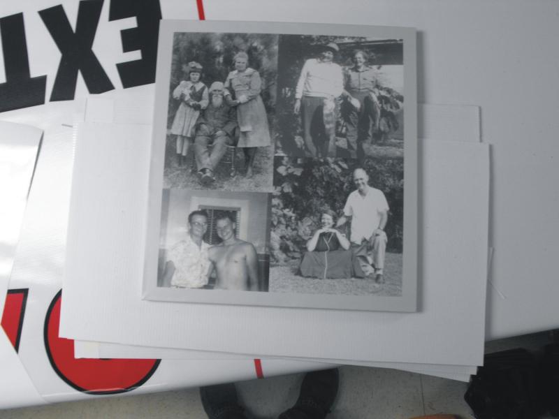

d fleming
Just finished. SImple wrap with some very old family pics for Dad.
