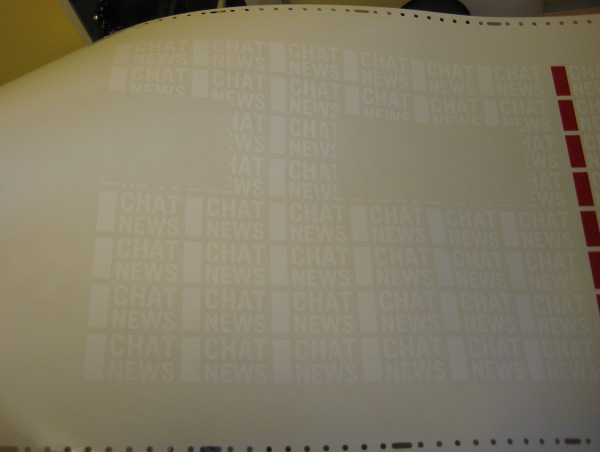

I have a problem with my Gerber Edge2 leaving very consistent streaks. I have tried changing the vinyl, changing the foil and changing the file I'm printing. Nothing changes anything. I've never had a problem with the machine in the 3+ years I've been using it and it was printing just fine yesterday. I tried cleaning the print head extra well but there was no change.

I've tried a different file, not a different cable. It was printing flawlessly yesterday. Definitely more than one pixel.
Tony Teveris
It's too uniform, I think it's a cable within the printer itself, not the cable from printer to computer. Check for loose connections under the hood.

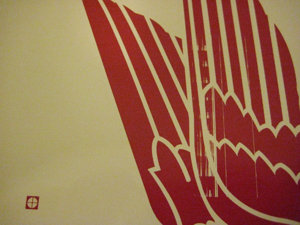

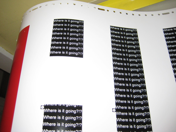

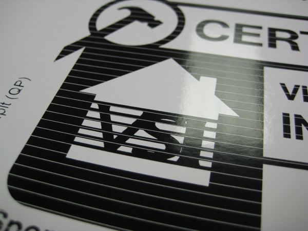

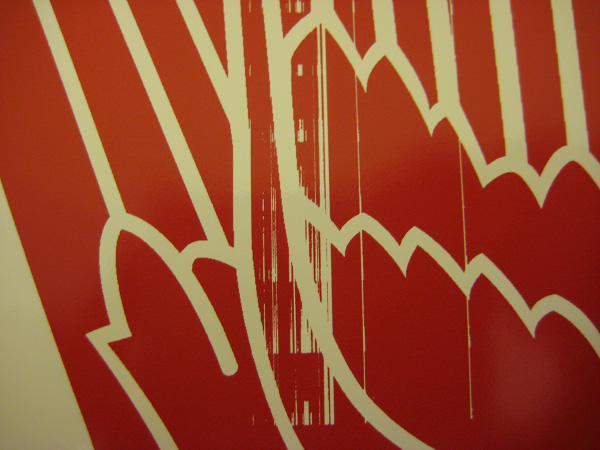

Similar situation to yours.... but I can't find a way of repeating it. It seems compeletely random:
The EDGE just decides to not print a certain section of the print. It's ALWAYS the same section along the y axis.
Sometimes it's just a little (see the red wings), sometimes it's a lot (see my black test bars). Sometimes, it even starts alright, then craps the bed, then comes back (see the white text).

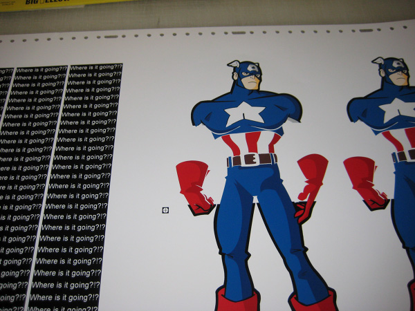

What really gets my goat is when it's a multicolor job, and it's the LAST color to go down (see Captain America). At least with black I can start the print back at home, and try over... but sometimes it'll screw up on the 4th color of six or something.
I noticed Tony mentioned lifting the hood and making sure eveything was tight. I did that for all the cables I saw in the bottom of the machine. Where things got a little tight and hairy looking under the TOP cover I was a little nervous, and made sure that at least what I could see and get my fat fingers into was well seated....

The streaks are vary consistent. If I send over 4 of an item it puts the streaks in the exact same spot on each item. It is doing it to each file I have tried. I changed the serial cable from the computer to the Edge with no change in the print so that is not the problem. I tried poking around under the hood and cant find any wires that are broken or loose.

On the first with the wings, looks like a problem I've had before.
http://www.signs101.com/forums/showthread.php?t=31047
on the one's with the blocks that "fell out" I know this sounds like a stupid question, but are there any rectangles hanging out on your design with a white or clear fill on them? That one has me baffles, never seen that one yet.
Browner
I believe it's different. I tried to get a "closeup" view of the misprint, indicating that it was definitely a pixelated (intentional) miss vs. material mismatches... and it's an EDGE "1".
On the one's with the blocks that "fell out" I know this sounds like a stupid question, but are there any rectangles hanging out on your design with a white or clear fill on them? That one has me baffles, never seen that one yet.
No rectangles hanging out. Same job printed three different times. First time it "missed" , second and third times it didn't. Went to print Cappy and it starts "missing" again.
I like the theory that it's cables INSIDE of the EDGE. I'm also wondering if there's a set of cables going to the print head that would "section" the print... because as random as the issue is, it is ALWAYS in the same vertical "quandrant". It would be nice to know what I'm looking for. Is it data or power?!?!?!
