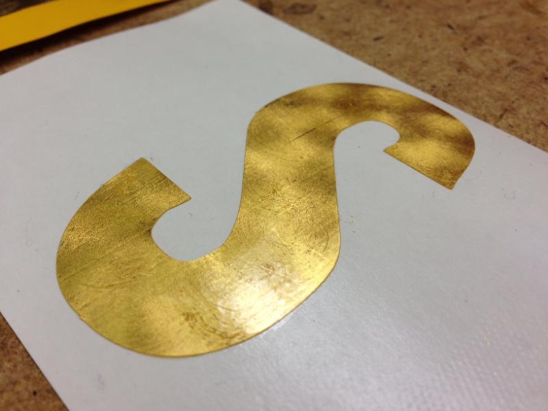

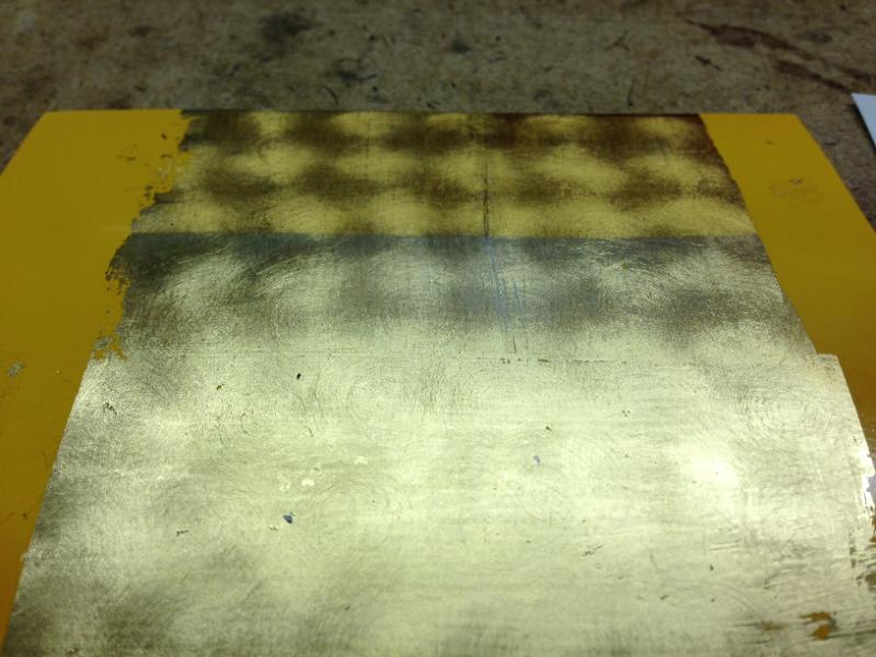

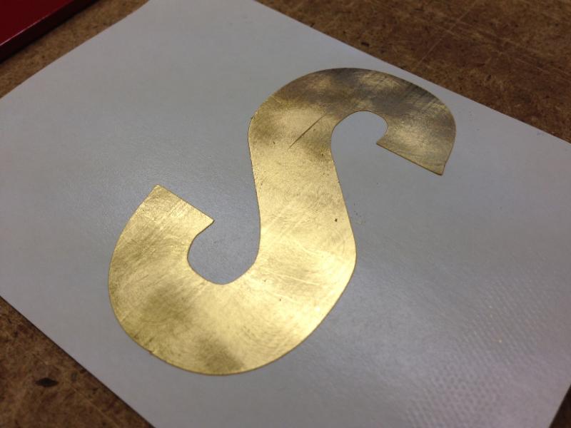

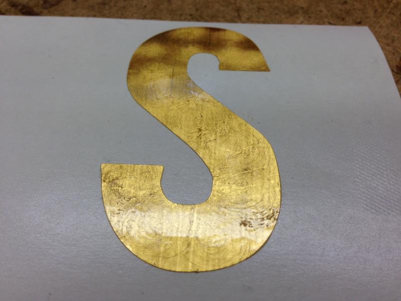

I have been working on gold leaf gilding. Everything seems to go alright until I get to the turning part. When I turn the leaf, it almost seems like it is gouging it. Then it really sticks out when the sealer is applied. I am using a cut up Crown Royal bag stuffed with cotton to do the turning (this was reccomended on the internet), and waiting 5-10 minutes after the leaf is applied. What am I doing wrong here???
Before the sealer was applied:

After sealer:
Sealer only on top half:

You may need to wait longer before spinning, even longer for the clear.
What are you spinning with? I usually use a dowel or something like that, put
a little cotton wad on then wrap with velvet, it should be a flat tool when done.

It looks like you tried to turn the gold too soon. Try waiting longer. On some projects I wait the next day. use a clean piece of velvet .and you don't need a lot of pressure.
It looks like you could wait a little bit longer before you lay your goal. You'll get a higher sheen.
And it looks like you burnished top to bottom, I like to burnish right to left you get more reflection from the gold.
Hope this helps.

Looks like you put the leaf on before the size was at the right tack.I've found engine turn is done best using slow size with the leaf applied at the proper tack.No need to clear coat unless its going on the cab doors of truck or somewhere where it will be touched. Also get rid of the royal crown bag and get real velvet.Get the book

Yup, spinning way too soon, and it looks like you didn't let the size dry long enough. As mentioned, purchase real velvet and stuff with cotton. I'll sometimes wait until the next day to spin the gold.

Looks like your gold size is too thick, leaf applied too early when wet, and spun too soon tearing it.
The tack of the size is very important. Fast size has a short window maybe an hour or so, slow size has a longer window to apply the leaf up to 24 hrs and produces a richer Gild.
Best to be patient before burnishing. Next day is fine...
I burnish lightly w/ cotton horizontally to brighten it and then engine turn.
Proper velvet is key not the stiff hard imitation stuff.
I'd highly recommend hand burnishing to get the feel and pressure correct.
Take some cotton, roll it up in a very tight ball and wrap w/ velvet and a rubber band.
Make a few different sizes depending on the lettering size.
Start turning before you hit the leaf and don't go too deep.
