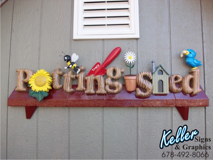

Here is a sign I was hired to do. It was for the customers wife as a birthday present. It is mounted on her potting shed.
I cut the letters and main shelf shape out of HDU on the Multicam CNC table. Then carved the detail in the letters and main body. The applied pieces I cut on the band saw and hand carved. Then I primed, and painted it all with One Shot lettering enamel.

Great work...all you carvers reading this, I can handletter, gild on glass, signwrite a wall or a roof, whatever...but this stuff I see you guys do, now that's what impresses me.
