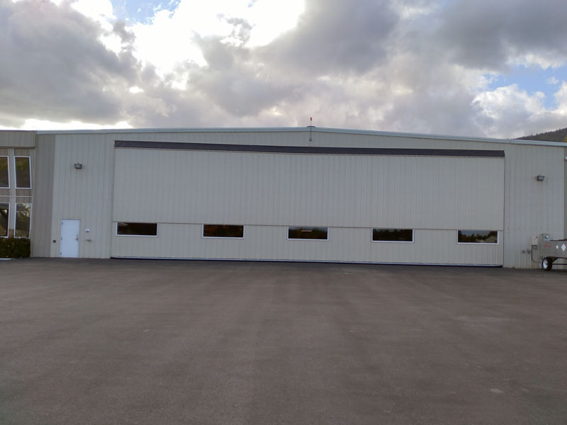

Looking for some ideas & suggestions on covering a hangar door with a panorama image. The installation area is the partition above the windows in this image, running about 60 feet wide by 15 feet high. Corrugated metal siding. If panels are applied they can't be heavy because the door lifts up.

Applied right to the siding? Looks like a nightmare installation with the corrugation and all the rivets.

No, not easy... But what does your client expect? They are asking a lot. Set their expectations to a reality level.

If I was approached with this FIRST I would find out what direction that hangar faces. If it faces south or west I would have to inform them they are not going to get a good lifespan out of anything. Normally it would not matter but this is going to be huge job. I would use 15 run s of 4' x 15' strips vertical using two guys for install, scissor lift would be great for this application. Thats gonna be some weight on that door though

My first inclination is wrap it since it would be the lightest application. As an alternative, since it’s a tilt up door and not a roll-up, you could use a banner with industrial Velcro. It goes on a lot faster than either a wrap or panels and be much less expensive to change graphics every few years. The banner won’t pop the way laminated vinyl will, but it’s worth considering.

Banner frame and banner. Would take some work for initial installation but makes life easier for installation and change outs.
I also like zspace's idea of banner with industrial velcro. Only issue is the corrugations of the door. Otherwise would be a slam dunk.

Either wrap or paint. Either way it's not cheap or easy, but the right design will make it lees painful. For instance a nice sky full of clouds with a few vintage planes. Actually a hybrid design, paint a cloud mural and add some vinyl print planes

Without an engineers approval or some other way to verify capacity, I'd be hesitant to do anything except a wrap. A banner that size would be very heavy.

Are you designing this “panorama” for the doors? Hand painted sounds the better route to take. Like said, banner will be to heavy and vinyl lining up and installation will be a lot of work.

Thanks all for the ideas, doing a banner hadn't even crossed my mind yet. I think applying vinyl directly will have to be a pass for me, just not enough experience, and it would have to wait until next spring because it's getting too cold here already. The door faces east.

If it ended up being a banner, is a mesh banner the way to go? (Just for lighter weight)
Can anyone elaborate on a banner frame? Wood or metal, and how thick?
Would you do one gigantic banner or hang it in panels? (fastening with grommets crossing over at the seams) I looked at some oversize building banners online and they look like a single piece. Has anyone done those and how did you fasten them on?
I like Billct2's idea of painting the sky/clouds background, then installing printed vinyl of the planes. Much more do-able than an entire wrap.

Billboard face is going to be more inline with a mesh banner as far as weight goes. Our 12x24 faces might weigh in at 35lbs. It will be a low resolution print, but you can get one for under $0.70/ft, install with screws directly into the door through grommets that you'd have to add yourself. Oversized building banners are also just billboard faces, typically screwed unless made to fit into a frame.
This is the sort of system for a banner frame. Ideally ordered cut to size. I don't think we've ever done one ourselves, but the idea is solid. You just have to account for the added weight of the frame. https://britteninc.com/products/display-hardware/framed-systems/heavy-duty-banner-frames
And this door is almost triple that size. For something not designed to hold an extra 200/some pounds, does it sound like it's gonna work ?? You hafta keep in mind the weight of the frame..... AND the banner, so why not attach something that weighs around 175lbs and see if the door can handle it. Put it along the entire length to evenly distribute the weight. Testing now will be better than after spending time and money on the wrong approach. Afterall, you're the professional, so we hafta get it right the first time round.
