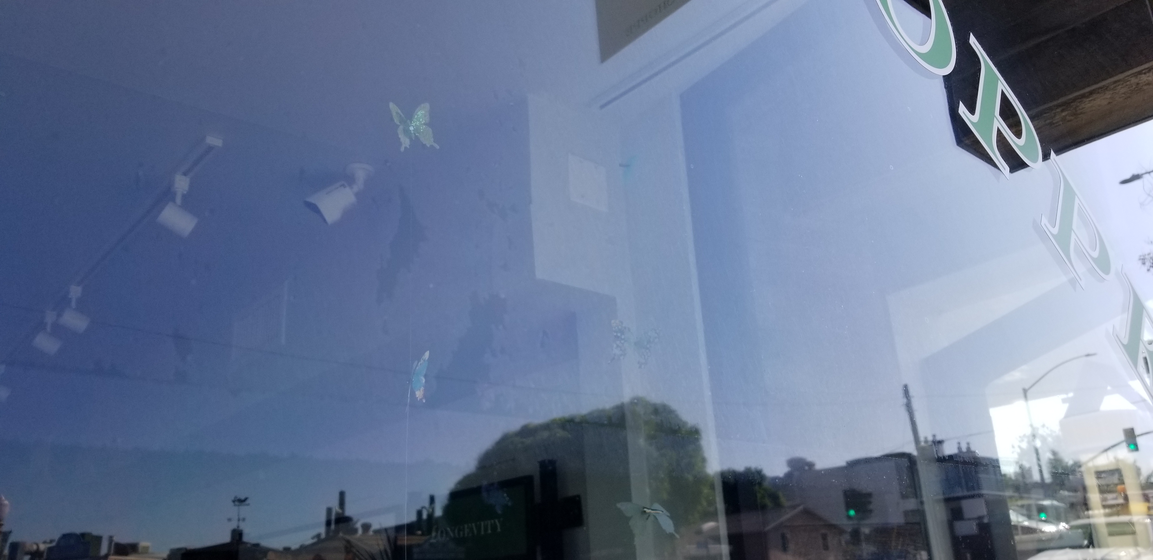

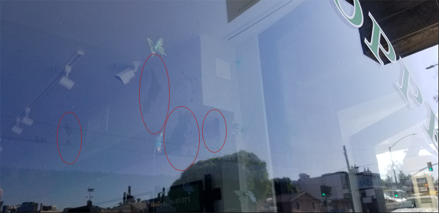

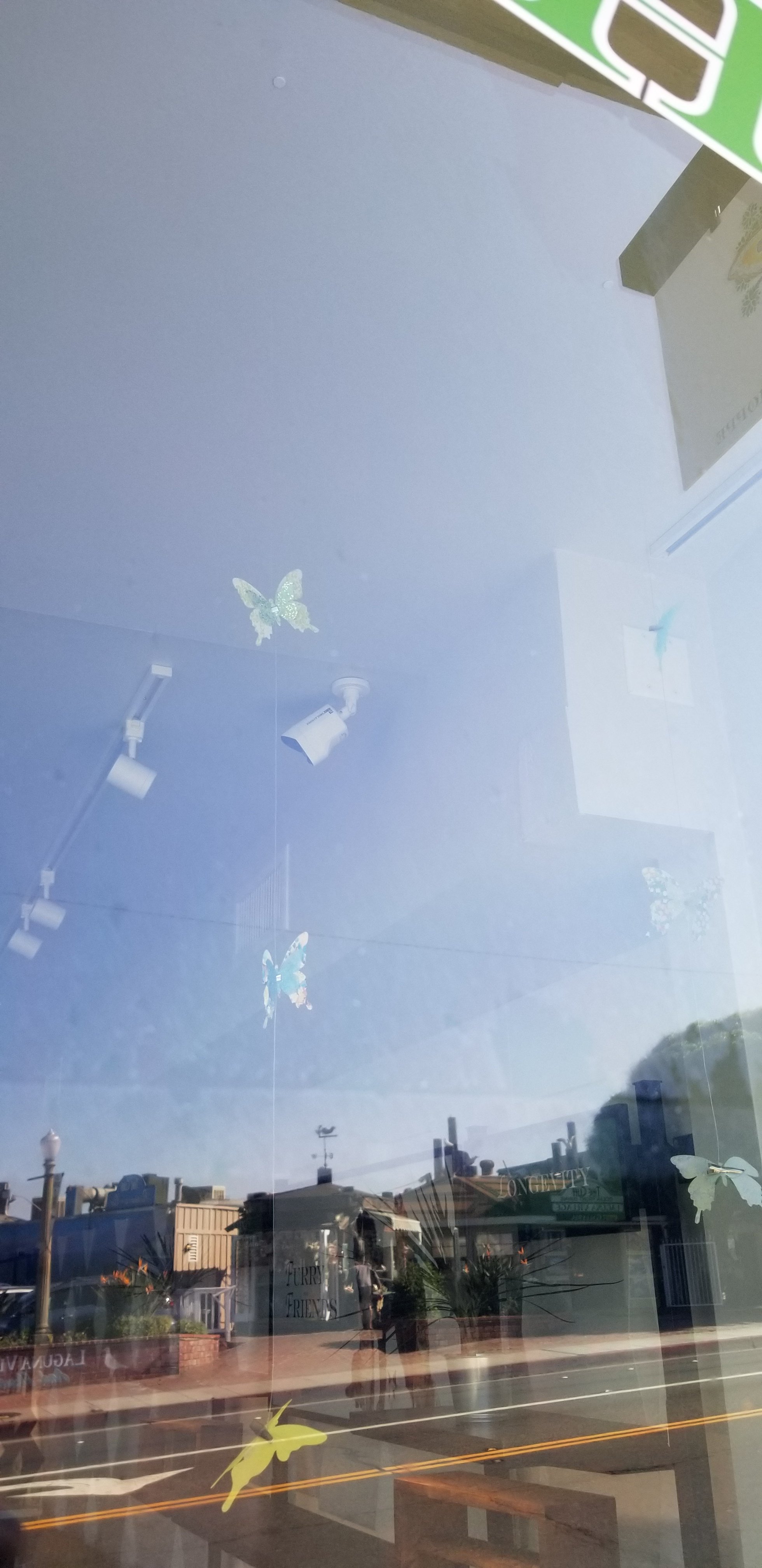

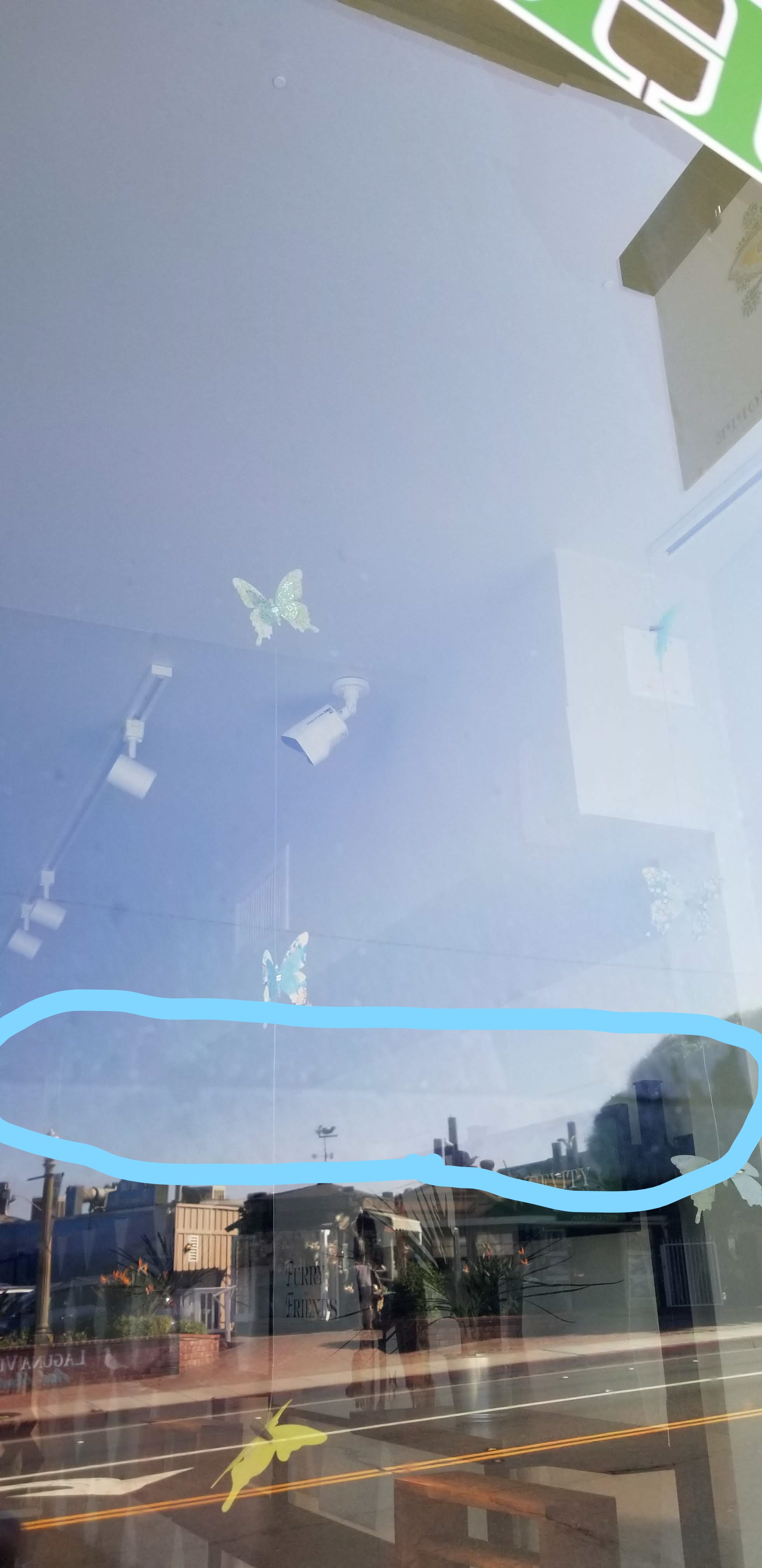

So here is a bad update.
There is no tint on the window but a protective film and our trafertape took off one layer of the film and there we are. Don't know if you can see it in the pictures

I'd figure out who may have done the glass work in the building, or find a local shop and see if they will meet you on site to tell you what you are seeing. The idea of a protective film getting ripped off by premask is kindly laughable. You may be able to offer to fully strip the garbage film off the windows...?
Thank's JBurton I will and hope for the best :(
GAC05
Quit buggin' me
Protective film on the exterior glass? That is really odd. There are window films that install on the outside but they are used when there is little or no access to the inside. What you have there does not look like that at all.
Old or failing tint (installed inside) can look like what you have there.
3M tint film have (or had, its been a while) a scratch resistant coating that breaks down over time and gets brittle. Put tape or premask on it and it comes right off like peeling sunburn.
Definitely need to find out what the window treatment was before you try to fix anything.
