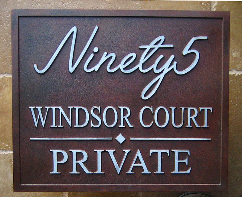

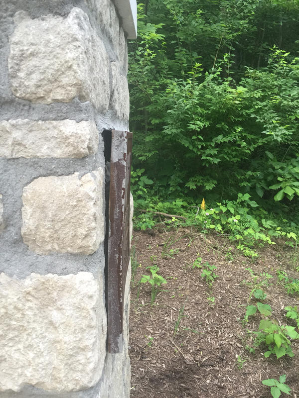

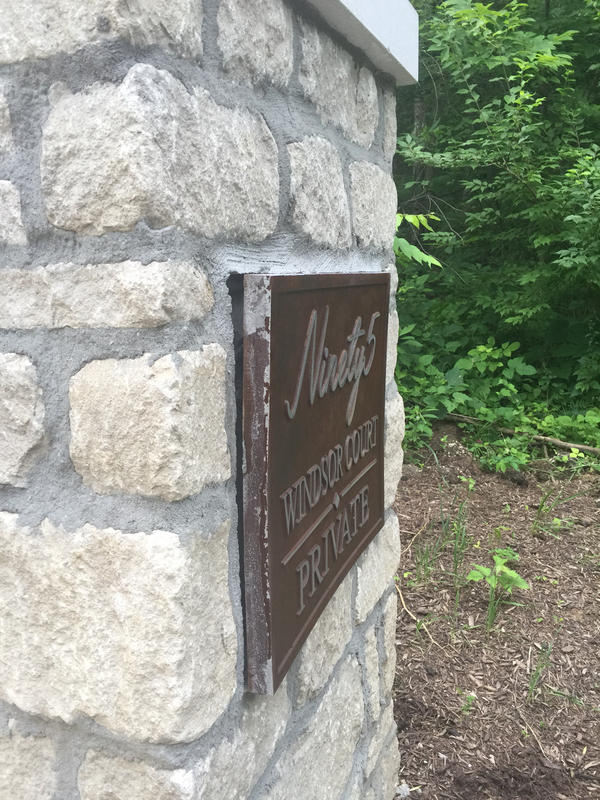

I did this plaque out of 1" Corafoam 31lb. carved, cold sprayed iron both sides, rusted the iron and sealed with Permalac Satin in March of this year. Just got an email with a couple of photos that are very upsetting...the sign has warped and is pulling out where the mason had mortared it in. I have assured the customer that I will correct or replace the sign but said I needed to find out "why" it warped so this did not happen again.
I have used all of the makers of HDU and Corafoam is by far the best with the least amount of issues so I am at a loss why I have this warping especially since the entire plaque is coated with the same metal. The sign is 19" wide x 16" tall x 1" thick.
I would appreciate any help you can give, let me know if there is any other info you need. I will post a picture of the sign before it left my place and the picture sent to me yesterday.

Only seeing those three pictures and not in person, this is gonna be an educated guess.
I'd sooner think, judging by the lousy mortar work performed, moisture, bugs and all kinds of other things got behind that panel and caused some kinda problem. I don't know the climate change or the morning dew rate, but you get enough crap back there..... and anything could go wrong. Heck, even vandalism to an extent could've caused this.

Can't see how it was held in place. If it was just placed on the space and mortared around the edges I'm not sure that would hold it, it's not masonry. I think it should still be studed and glued, or at least glued.

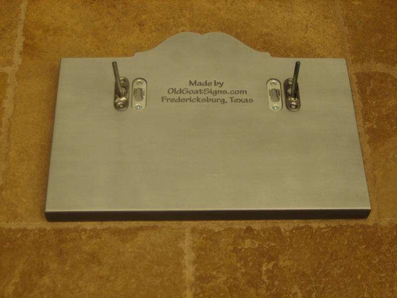

I have asked the customer for more information as to whether it was inset flush with the face of stone or if it was protruding out, asked for a front on shot. I usually make standoffs for any permanent install (see pic_ instead of keyhole mounts but since I have not been able to discuss with the mason what he needed it is a guessing game.
