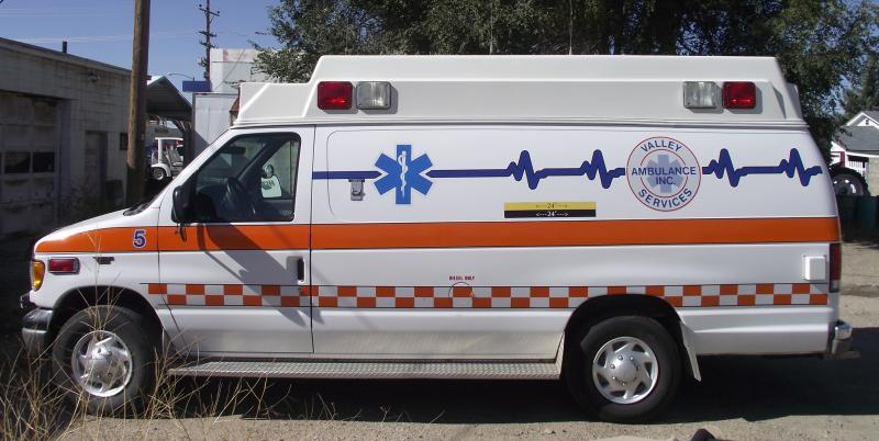

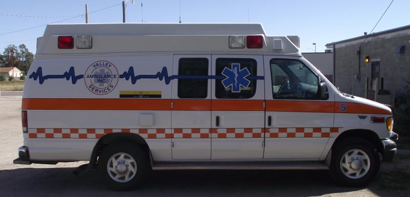

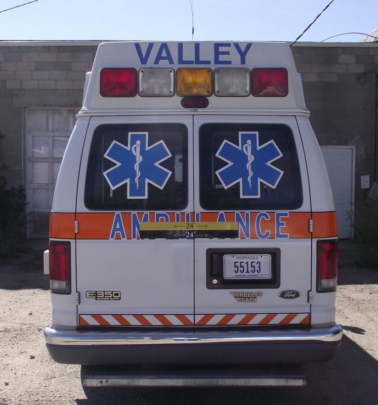

Hello,
I have never took off reflective decals before and i have a client who is wanting me to take off all the graphics on a ambulance vehicle and i have no idea how long it is going to take to take off the old graphics. everything in these pictures is reflective and it all is to be removed. any ideas or pointers on what to charge / take it off?
Thanks!!!

depends on how long it has been on and what brand it is. Some comes right off, others we pressure was off. Charge time and materials. Bidding removals is a big mistake. Been there, done that.
drive
We use this formula:
(Shop hourly rate) x (hours it takes)
We always charge peeling by the hour. Especially removing reflective! You just never know have long it will take and how delicate the operation will end up being.
Spencer McMurtry
the client is wanting a estimate on what is going cost before giving me the job, i was thinking 7 -10 hours at my shop rate $75/hr. at that price i wouldn't be surprised if they say no
trik
Tough to bid! I had a similar job for 8 vehicles. I told him I thought it would be a nightmare to remove, so I made him a deal, I would bill him for 3 hours on the first vehicle, if I was close to done we would have an idea, if not he would be better off taking it to a body shop to have them sand off the decals, they had been on the truck for years and years...lol About an hour into it I realized there was no way this was happening, and he paid $150 for my time and advice. Plus I got to do all their trucks once he had them repainted, he got a great deal from the body shop for 8 vehicles, worked out great for all. Good luck!
If all three lines are reflective count on about 5 to 6 hours if you use a vinyl zapper.
Quote them $500 to $600 dollars and guarantee it won't go over the 6. Buy yourself a zapper for about $400 and you'll make a little money for your time, but you'll have a tool now that will do wonders for you for the future.
MikePro
everyone complains so much about removing reflective...
heat and patience is all you need.
i'd do it in 5hrs, but still charge $600.
...$450 if he pays cash, and gives you a week to work on it and prioritize other projects before it. Although you could always offer to have it ready for him, tomorrow, for $800.
