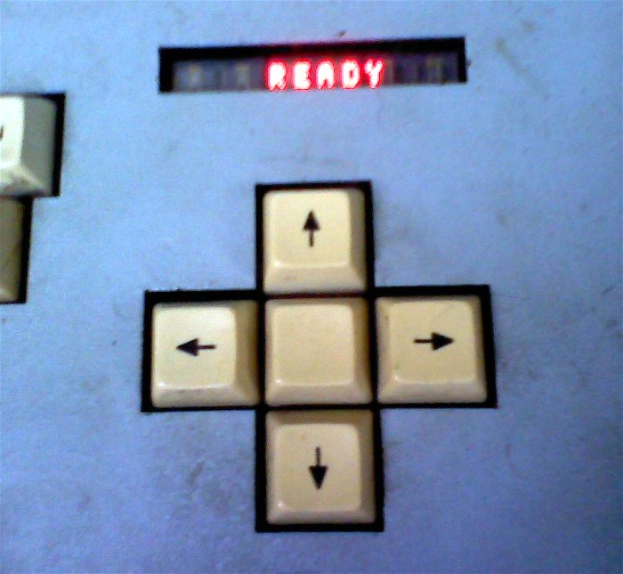

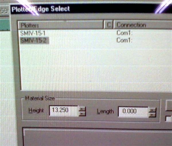

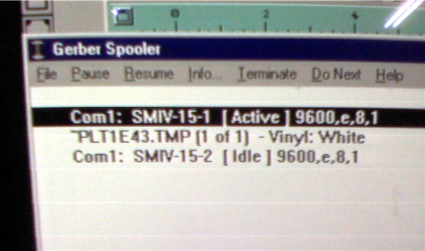

When I am in GA6.2 and send to the plotter nothing happens.
The job is listed in the spooler but the plotter doesn't move.
I think it's a setting
(see first pic)

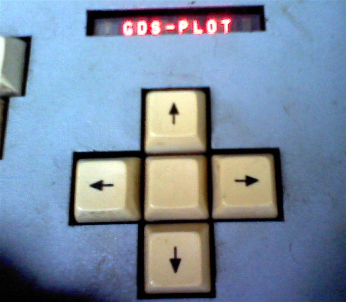

I think I used to have to set it to GDS Plot but I can't remember.
(see second pic)

Hmmm its been a long time, one thing you could try is to install it on every com port that seems to be available to you in GA and try selecting each port one by one in plotter select when you output, possibly it does not like com 1.
and you might have to hit return after you go to GDS plot, I seem to remember them switching to "gds ready"

Did you shut down and reboot when you hooked it up? I seem to remember Gerber has trouble detecting ports unless you reboot every time a port setting is changed or assigned.
Tony Teveris
As Craig said
"and you might have to hit return after you go to GDS plot, I seem to remember them switching to "gds ready"" - thats the only thing I can think of. You pics all look correct.
I think we have one unit but I need to find it and I know it's NOT in the building I'm in.
Jillbeans
THAT WAS IT!!!!!!!!
