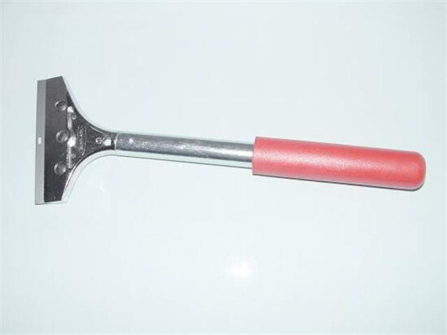

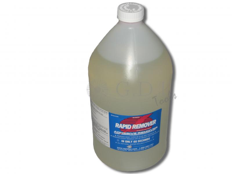

Just scrape it off. If that doesn't work try spraying rapid remover on the TOP of the vinyl and letting it sit for a little bit, then Scrape. I noticed that if you spray it on the top of the vinyl it still breaks down the adhesive underneath.
BTW don't use a little ass razor blade like others are suggesting.
